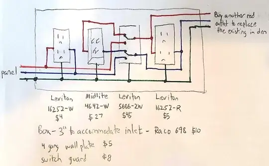

Here I'm planning a nice implementation of the advice in the accepted answer. This plan provides raw and UPS power to the basement location and also through existing house wiring to a den outlet. It includes a UPS bypass switch allowing for UPS service.
The trick was to find a DPDT switch that would switch live and neutral at reasonable cost, and an inlet, both of which would fit in a standard multigang box with some feasible cover arrangement. I could have done it with sectional box covers for about the same price but this plan uses a standard 4-gang Decora plate. It's easier to build and looks better.
It's all limited to 15A, which works perfectly for what I'm planning.
The key is two devices I found:
  • The Leviton 5686-2W switch. This is a 15A DPDT switch. It's intended use is to switch 2-pole power between two devices, but it works here. And this specific model is in Decora profile and costs less than $50.
  • The Midlite 4642-W recessed inlet. It's intended use is to connect a knee-height outlet to a shoulder-height TV routed through a power conditioner at the lower level. But it's perfect here because it completes the project without requiring a special cover plate.
The Midlite inlet requires a deep box so I've included a Raco 698, and I'll also replace the den outlet with a red one and put a switch guard over the switch.
The outstanding problem is to pick a UPS that does all the things I want at reasonable cost. Probably time for some illusions to be shattered.
Here's the design: enter image description here
