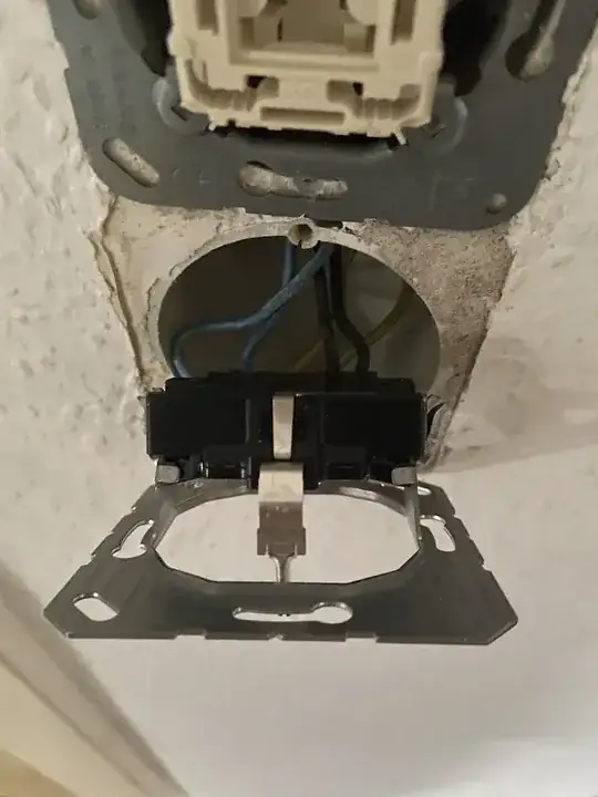

I have bought a house in Germany and there were some different color sockets in some rooms so we decided to change them.
I will now explain for just one socket not to confuse the matter further.
Switched off the electricity and tested (with electrical tester) that there is no electricity and then I replaced the socket nest.
In Germany the blue cable is supposed to be the Neutral and the black is supposed to be the Live/Hot wire. Double checked it just to be sure and installed the socket like this.
I decided to buy a Socket tester and test the socket anyway (I want to make sure all the sockets at home are without any faults) - I bought this one "Kaiweets HT106D socket tester pro".
When testing the tester showed "Live/Neutral Reverse".
This is weird. I connected the black cables(2) at L and the blue cables at N. And the tester says that the "Live/Neutral Reverse" is reversed.
I said okay, I will now reverse and connect the blue cables(2) to L and the black cables (2) to N (against the standard). And then the tester lights "Correct".
Here are some photos of the socket, installed with the wrong color wires on which the socket tester lights it is all correct:
The front of the socket, where is clear that the L is on left, N is on right and the ground in the middle: The front of the socket, where is clear that the L is on left, N is on right and the ground in the middle
The wiring after I reversed the cables and connected them against the logic (here they are visually wrongly connected) The wiring after I reversed the cables and connected them against the logic (here they are visually wrongly connected)
The tester lighting correct, where the cables are connected against the logic (blue in L and black in N).
Can someone give me a an advice: should I believe the cable colours or the Socket tester lights?

The socket you have there is called a "Schuko" (or CEE 7/3 and 7/4, to be formal).
This socket is entirely unpolarized, by nature. The socket design makes no differentiation between hot and neutral. The plug can simply be flipped over, and the two are exchanged.
Part of a genuine CE listing (or the third party tested TUV, BSI etc. ratings) is that every appliance must be designed to be safe with either conductor hot.
So the simple answer is that when you get "Hot-Neutral Reverse" on a tester, it means you plugged the tester in upside-down :) Really, we could do a whole comedy sketch here, because it's entirely a matter of perspective!

I bought 3 pieces of the same tester, and all of them were wrong because they expected neutral on the left and live on the right pin. Which is wrong. I assume it is so in china or some other countries.
So I had to fix those testers. I had to open them and swap wires for live and neutral.
It seems your wiring was ok before, and the problem is in the tester.

The key takeaway is that your tester is good and your socket is wrong.
As @Harper has pointed out in their answer, the plug and socket system was developed as Schuko is now known as CEE 7/3, sort-of standard.
Now CEE 7/4 does require a standard of wiring that is basically which you have had before "correcting" things.
Proper CEE 7/3 socket wiring
Also, in any region with "polarised" sockets (like the US, Australia, Japan, Switzerland, the UK, et cetera), the live pin is always on the right.
If you have mild OCD like me, and cannot stand the label being wrong, then I suggest you do what I used to do with these sort of sockets: install them upside down – provided that you have enough wire length at hand for that.
Short of this, grinding out the marking or painting over it (e.g. with a lacquer marker) is also an option.
It is important to recognize that there is no EU requirement for the wiring; instead, each member state may decide if they do or do not mandate some sort of wiring. As others pointed out, specifically in Germany, you may be legally liable of messing with the standard wiring should anyone figure out, and criminally liable if someone expecting the standard wiring pokes into the left hole with a conductive object and gets electrocuted in any serious manner.
Such things like the wrong labeling on sockets happen specifically because sockets and plugs are explicitly exempt from CE certification/declaration of conformance.
The best way to check your plug polarity is to get some simple multimeter and measure the voltage between ground and receptacles sockets. Neutral should be close to zero. If it is blue wire, wiring is correct. Mixing the color of wires is rare mistake, electricians choose color automatically. Tester wrong is more probability.
