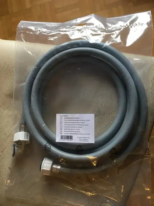

I got a new washing mashine from a friend. As we couldnt get of the tube, i had to buy a new one. Now it seems i am missing an Adapter.
Which Adapter do i need?

Unscrew the spigot from the tap and then the washing machine pipe will screw straight on to the 3/4 thread.
Edit based on comments: This is a picture of a "normal" standard replacement hose. Do note both ends have plastic fittings which are standard. there are stainless wrapped versions but they are only rated to the same working pressure anyway.
Used these many times and the only time I ever saw one of the plastic nuts break was when it had a gorilla crush it with mole-grips, hand tight is more than ample.

  • now i feel very stupid and thankful at the same time. It seems to work, thanks! – Tlatwork Apr 10 '21 at 10:46
  • OP Tlatwork note that you do not have to tighten the plastic fitting more than is necessary to seal. The rubber ring is the seal. Excessive tightening could introduce stress in the threaded plastic fitting and it could fail suddenly and without advance indication. In the US the ends of such hoses are steel or brass. – Jim Stewart Apr 10 '21 at 12:22
  • This looks like a new hose. In the US failing washing machine supply hoses are a major cause of residential flooding. The ends don't fail; the hoses age and rupture catastrophically. – Jim Stewart Apr 10 '21 at 12:33
