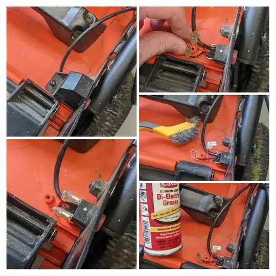

I have the same mower. I solved this exact same problem today. That safety switch (the one you said that you haven't tested yet), THAT'S the culprit. It's a deadman switch, if it loses contact for even a second, the mower will die. The switch connections are not well protected from the elements, and prone to dust, corrosion, etc.
You need:
  1. a small wire brush
  2. dielectric grease
Remove the connections of the deadman safety switch. Clean the spades with the wire brush. Then slather the spades with dielectric grease. Pictures included below.
diy mower repair collage
