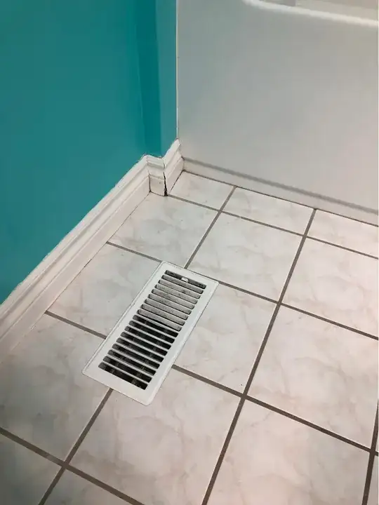

We have a heating vent located on the floor close to a shower. Occasionally when the floor gets wet it can act like a drain and it causes issues on the ceiling of the floor below. I could use caulk to permanently seal the vent cover to the floor but I don’t want to do something permanent like that. What are some other options?vent cover in bathroom

    Does the water leak into the airduct, or around it ? – DJohnM Apr 18 '21 at 01:51
    Why do you deem silicone permanent? If under the register, you can still scrape it away at a later time, cutting under the register with a utility knife. – P2000 Apr 18 '21 at 04:04
    Do you plan any renovations here? Could be a good idea to bring the register up into the wall and have it vent out just above the skirting board, leaving the floor to be a floor. – Criggie Apr 18 '21 at 04:24
    If you only seal the edge, silicone is not super hard to remove. Once it cures it's no longer adhesive so if you have skilled hands, you could remove the grate, put down a well planned bead of silicon in a ring so the furnace grate sits on it once it's cured. If you can get a level top it will seal, and if you don't, it will be a dam at least to the height of the bead. – K H Apr 18 '21 at 04:59
    I like those ideas. I’m going to use silicone. At least temporarily. Btw, the way the water was getting under the vent it happened to be getting around the air duct (not in it). – Michael J Swart Apr 18 '21 at 05:16

A splash guard at the corner of the tub may be enough:

I would first try to prevent that much water from getting out of the tub / shower. As a back up possibly a 1/8” bead of silicone around the perimeter of the register. Even tile floors can rot out the framing members that support the floor so preventing the water from getting out would be my first priority.
    Siliconing the register may really be all that's needed, without the bead. I have the identical issue, and a combination of prevention and silicone is sufficient even when the splashiest young one takes a shower. – P2000 Apr 18 '21 at 04:01
Don't caulk it, that's just adding to the problem. Caulk is messy, and in this kind of higher traffic area it's not going to last very long, so it's only a matter of time (probably very little time) before the water finds a way around it. The best way to fix this is to move the floor register up into the wall where it belongs, but doing that would be pretty involved and probably more hassle than you want to deal with.
Instead of caulk, I would get some silicone gasket material and use that to create a seal between the register and the tile. It might take some searching, but you should be able to find some that is the right thickness (maybe 1/8" or 1/16" ??) and has a permanent1 adhesive backing on it. Carefully apply that to the bottom edges of the vent cover and tighten it down enough to compress the gasket. It will be much less messy than trying to caulk it, and you'll still be able to remove the vent if needed (like when you drop something valuable down there).

  • That makes sense. For the short term I’ve made a sort of gasket with what was on hand, plumber’s putty – Michael J Swart Apr 19 '21 at 01:17
  • if you have a problem with water entering through the vent grate, you might consider replacing it with one that sits a bit higher (but that's going to stub a lot of toes). – Z4-tier Apr 19 '21 at 01:22
  • :-) I see what you’re saying but the water seeps along the grout lines and under the grate. – Michael J Swart Apr 19 '21 at 01:25

To stop direct intrusion (not just side seeping) you can buy magnetic register diverters that are clear. They would sit on top of the vent and you could direct them at the wall, where it would deflect any water dripped straight down.
As to side seeping, if you're looking to avoid caulk you can buy closed-cell foam weatherstripping (find a thin variety). Not the greatest over time (water will erode the adhesive) but easily reapplied and you can still remove the vent as needed.
