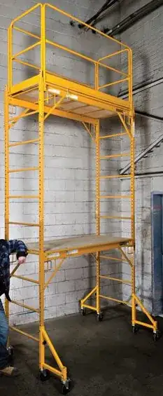

I've discovered something that is growing on me. A rented "Baker Scaffold" with independently adjustable legs. The one pictured can be rented for $70 a day for both levels with guard rails and outriggers. I could only use three outriggers in this location. I'd remove the casters and make wooden shoes to protect the doors from the legs of the scaffold.
Pros: This is by far the safest option and it's cheap. Cons: It will be an entire day's project including fetching and returning the thing.
I'm also thinking of approaches to build a platform for my own ladder. I think I can do it for less than $100. It would also be a whole day's work and less safe. The key to making it cost less is that I do not need an actual 4'x8' platform, I only need strength where the ladder's feet will be. So a large beefy sawhorse made entirely of 2x4s to hold up two feet.

    This is, I'm sure, the safest way to do it, assuming you have levelers long enough to reach down to the basement step on which one end needs to rest. That shouldn't be an issue to rent those. My FIL & BIL purchased 4 sections of scaffold ~25 years ago. We used it a couple of summers ago to work on a porch rebuild. I rented adjustable legs & feet to accommodate ~4' difference in height from one end to the other. 2x8 blocking on the steps would help make up for leg levelers that aren't long enough. It's _very_ easy to set up, too. – FreeMan Apr 20 '21 at 13:14

  • Looking now at the answer I just posted and imagining the effort to build and take down that scaffold with no prior experience, this answer (the window) is now creeping its way to be my favorite. – jay613 Apr 20 '21 at 13:02
