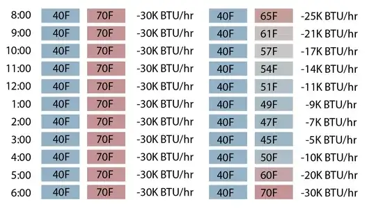

Here is the science-based thermodynamic law that drives all this.
Suppose you have 2 spaces, A and B, at different temperatures. Between them, there is some level of thermal insulation.
No matter what is true about the insulation, this rule always follows:
Thermal transfer is proportional to the difference in temperature.
Take any random insulator (green) that happens to have nice round characteristics of passing 1000 BTU/hr per degree F difference:
You can see where keeping this thing cooler will result in less temperature differential.
How to apply this law to the question at hand
This is for a physics lesson, and includes exaggerated hypotheticals for educational purposes, designed to be illustrative rather than real-world numbers.
Two "example" houses. One is kept at temp, the other managed with a programmable thermostat which turned the heat off at 7:00 and kicked the heat back on at 3:30 so it'll be comfy at 6:00.
And let's presume cloudy day with constant temp, just for simplicity, because we're here to understand a law, not model a complex system.
Obviously the insulation factor, thermal mass and heating capacity of this house are unusually bad, and the "constant-temperature day" is unrealistic too. But we're here to learn. Some of us, anyway: for others, this is an 'inconvenient truth'.
What's positively true is that the house on the right lost less heat.
Here's the thing: Heat not lost is retained in the house. The house on the right had to make less heat simply because it lost less heat. Yeah, the house on the right has to run the furnace hard in the afternoon "to catch up"... but since furnaces run at only one speed, the simple fact is that the right house's furnace had to run less time in total than the left house's furnace. We know that because the house lost less heat, and there'd be nowhere else for the heat to go.
Except it's more extreme because of solar gain
In our house, the mornings are cold, and the furnace runs of course. And it runs all morning. But, solar gain has been heating the house's exterior, chasing off the cold of night... and this heat starts penetrating the insulation and warming the house in earnest. Since the house is already at 70F thanks to the furnace, the solar gain not only holds it there but also warms the house further - sometimes too much! So the furnace does not run again until dusk. We were there the whole time because of COVID, but imagine if a programmable 'stat had shut off our heat at 8 am.
The furnace would not have run. The house would cool off, and would be ~50F when solar gain really starts pounding on the house. The solar gain would lift the house to 70F just as we arrive home to enjoy it. The difference being, with a programmable 'stat, we would not have been 'out' the fuel costs in the morning. So a programmable 'stat lets you make better use of that solar gain, by letting house temp take a "morning dip".

Your heater has one job: to replace the thermal energy inside the dwelling that has been lost. If replaced exactly, the temperature is maintained. For most structures with reasonable perimeters, this loss is a function of the temperature difference between the inside and the outside. 15 degree difference, lose X energy per hour. 30 degree difference, lose 2X energy per hour. So for any period that you can allow the interior to come closer to the exterior, the total loss is reduced and the heating load is less. (This is simplistic and ignores solar load, drafts, assumes the heater efficiency is constant, etc., but is good as a first-order assumption). Yes, you have to bring everything back up to temp at the end of the window, but there will have been less energy loss during that time, so when everything is back up to temp, less heating will have been required.
Note that the better the insulation, the milder the temperature, the less time you can have the system off, then the less savings you will be able to achieve by changing the setpoint. (At the same time, the less of personal impact changing the setpoint will have).
If you're a penny-pincher and are diligent about setting the thermostats to just what is necessary, then a programmable or smart system may not save much.
If you just leave the thermostats set to the same temp all season just because that's comfortable, a very simple programmable unit can make a difference. Even if you only have a few hours a day where it can turn down, a few hours a day over a season can add up to quite a bit. If you have a $100/month bill it doesn't take much savings to pay for a $20 unit. Admittedly, when you need multiple controls, the math isn't as good, but if you're planning to be in the house for several more years, that's a lot of heating days to spread out the ROI.

Imagine a tire is filled with compressed air, but has a tiny hole in it. The tire is the house. The air is the heat. The size of the hole is the quality of the house's insulation. As mentioned by @Harper, the more air pressure, the faster the air leaks out. But, there is much energy required to raise the pressure back up from a lower pressure, once or twice a day (when the people show/wake up).
People are not going to allow their homes to cool to all the way down to 40 degrees Fahrenheit (F) when they're away for the day, only to wait a long time for the home to completely warm back up when they return. So, to me, it ends up being the difference between the "leakiness of a tire" filled to 75 psi (or F) versus one at 68.
With this, my guess is that that difference translates to trivial money, annually, for a given household.
