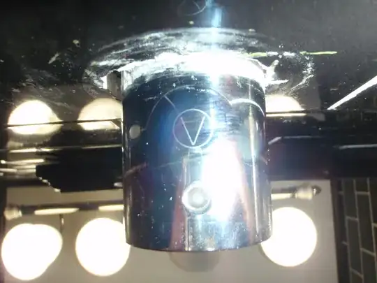

  • Can you provide a photo of the new fixture ? – Ed Beal Apr 21 '21 at 01:40
  • @EdBeal added a photo of the fixture, hopefully it's clear. If not I can try to take another – David Apr 21 '21 at 01:44
