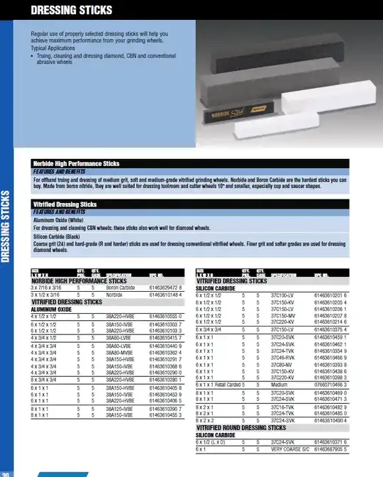

What is the difference between a dressing stone and an abrasive file? For example, items 61463610555 and 61463686100: www.nortonabrasives.com/sites/sga.na.com/files/document/Catalog-SharpeningStones-Norton200.pdf
They're both the same shape, size, and both aluminum oxide so I guess the difference must be in the binder but I am not sure what the difference would be for an abrasive file versus a vitrified dressing stick.

  • Questions that rely on hyperlinks and manual searches of external websites become useless in time, so it's better to chop the information up yourself and provide it in the question. Judging from the information they provide, your question would best be asked of Norton, but one offhand guess would be a file would have a binder that helps it maintain its dimensions. The best comparison I see with the information provided is that the file is for dimensional filing and the other stick appears to be for hand sharpening. – K H Apr 24 '21 at 08:26
  • I could put screen shots in, but the catalog is really spread out. Even the information for a single product is spread out over 3 pages. – DKNguyen Apr 24 '21 at 08:27
  • The link was also not the direct link I thought it was. – DKNguyen Apr 24 '21 at 08:35
  • You're asking about these two sharpening products in particular, but maybe it would be better to reveal what you want to sharpen or shape? These are pretty specialized stones, and there may be a genre of stone more effective or specialized to your use at a better price point. Most people want to dress their abrasives flat and clean them/clear the pores. Especially for rough work, diamond has become pretty cheap. – K H Apr 24 '21 at 08:47
  • @KH I just ordered a dressing stone by accident (plus it was a lot cheaper than the abrasive file) and was wanting to know what to expect and whether I should order the proper item since it's going to take a while for either to get here. – DKNguyen Apr 24 '21 at 18:32
The first product is a dressing stick, so if you have abrasive impregnated grinding machines, you use it to flatten and true them. A binder would be chosen to stay strong and hard with the heat produced. Generally with stone you want a dressing abrasive harder than the stone, but as they mention particularly cleaning and truing diamond abrasives, it appears it is adequate in this case to be stronger and harder than the binder.
The second product appears to be more for hand filing, sharpening and shaping high strength metal cutting tools like wood chisels and punch dies, so they likely have flexibility to choose binder properties that are better for low speed hand work.
