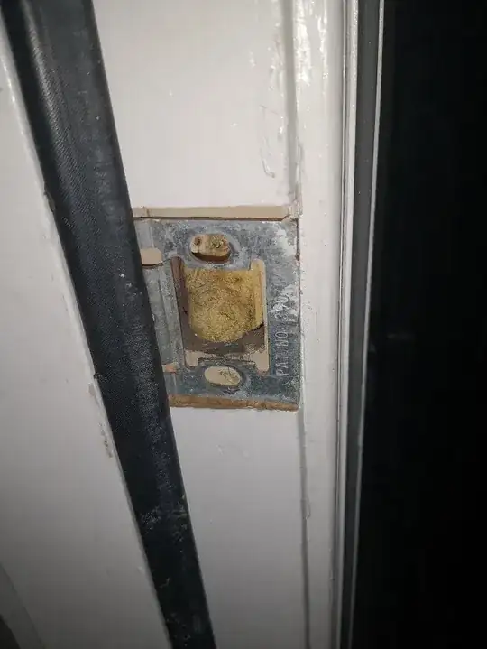

Good day everyone. I recently replaced my existing keyed Schlage lock with a keypad security lock on the door from my mudroom to my garage. The door is metal and the frame/jamb has thick rubber/silicone weather stripping. The new lock has been in place for a few months but the lock cylinder has become damaged do to extra stress created by the weather stripping and the new strike plate used over top of some weird sort of metal bracket that was installed with the previous lock.
I can't explain it well, but the weather stripping pushes the door back inward, toward the very edge of the strike plate. The new strike plate, installed over top of what appears to be a security bracket (?) is a tad too far and the deadlock plunger has become bent as a result. You can see this in the pictures I provided. This causes the latch to bind and not close fully. I can replace the latch but that won't fix the stress on the part caused by the use of these two brackets/strike plates.
Do I need this weird looking bracket? Without it, the door will shut fine without the added stress on the latch or deadlock plunger. I assume it's for added security as the rear of the strike plate has teeth that grab into slots drilled into the frame. I can't even find a name for this part.
I'd like to just be able to not use it and use the strike plate that came with the lock instead, but I feel removing the bracket will affect the security of this door. What can I do to give the door more room inside of the strike plate? I can't get the door to sit any tighter against the existing weather stripping.

That little plunger is called a dead latch. It requires precise and correct alignment between the door latch and the strike plate with no excuses.
The purpose of a dead latch is that if it is held in, the latch can't move. This defeats "using a credit card" to force against the latch's ramped piece to make it retract.
The strike plate, thus, must be correct for the dead latch. It must allow the latch to drop into the hole, but the dead latch not to. The best option is to use the strike plate supplied with the lock set, whose hole should be the right size so only the latch fits.
The dead latch should not be taking any damage because it should not be falling into the hole. It sounds like the dead latch is falling into the hole, and then, is bearing the full force applied against the door, including by the wind, which can be considerable.
Too big a gap between door and strike plate
Part of your problem may be the strike plate being too far from the door. (I can look right at the weatherproofing and tell you that!) In that case, the beveled latch is only going partway into the hole, and that is leaving room for the deadlatch to fit also.
The latch is beveled. If the strike plate is close like it's supposed to be, the hole is only big enough for the width of the latch, and the deadlatch can't fall in. However, if the strike plate is too far away, it aligns with a part of the latch that is not as wide (since it's beveled). That leaves room for the deadlatch to fall in.
The gap between door and strike should be very close - you should barely be able to fit a credit card in there. I bet you can fit about 6 credit cards in there!
I also notice the latch is "inset" from the edge of the door. That shouldn't be. You need to shim that back out so the latch is flush or even very slightly proud of the door edge. Here, every mil matters.
^^ How it's supposed to work.
^^ Yours. Note too-big gap and too-inset latch allowing deadlatch to fall in.
That type of weatherproofing makes "closed" ambiguous
If a door is not weatherproofed, there is a well-defined point where the door is positively closed all the way. With this type of weatherproofing, after the door first contacts part of the weatherproofing, you can lean on the door harder and harder, and the door will keep closing, moving more than 1/4" additional if you lean on it hard enough. This makes correct positioning of strike plate extremely difficult, but also, all the more important. It's a mistake to set the strike so the door is too loose; first it will bear a lot of dynamic force from being loaded in both directions by the wind, and second, people who pull the door shut hard will drag the latch past the strike plate, making for very sloppy latch action... and (again) allowing the dead latch to fall into the hole if the strike plate is too far away.
You say the oval screw spaces in the reinforcement are in the wrong place. I doubt that. I suspect the weatherstripping is making you want to put the strike in the wrong place. Since you're already having trouble with the dead latch dropping in, clearly you're already putting the strike plate too far out, and it appears you are near the outer limit of that oval. I suspect correct placement will be closer to the inner limit, but this will make the door very stiff to close, and you don't like that.
Well, you're going to need to sort that out. Decide whether you want to keep this weatherstripping and place the strike so you must pull hard to close, go with other types of weatherstripping that don't interfere with a positive "closed" position on the door, or get rid of weatherstripping.
The wood may be too beat up to take screws
It's also possible that the wood "meat" the strike plate screws go into has perished from over-use, and/or the existing holes simply making it impossible to get a screw to go in the correct position (since the screw seeks the existing hole). That thrashed wood fiber needs to be drilled out and replaced with some sort of filler. I would drill it and epoxy in a softwood dowel. It needs to be about the hardness of the underlying wood, not much harder or softer (or drills will "seek" the softer material).
You could use an epoxy with filler instead of a dowel; a blend of colloidal silica and fairing filler (e.g. West System 406 and 410) would be a nice compromise between softwood hardness and strength.
I've also heard of people driving match sticks into the screw holes (NOT with the flammable heads!)
So... it sounds like the door framing has been a real "slop job" and these issues were simply ignored by past installers.
You will need to move through each issue and correct it.
  • Shim out the latch in the door so it's flush, or a tick proud.
  • Shim the door, or jamb, or strike base, so the door and strike are close enough to work as intended.
  • Find the strike position so with the latch extended, but the dead latch retracted (tape it down), the door compresses your weatherstripping (if any) firmly for a good seal, and without allowing slack of movement.
  • Remedy any issues with chewed up wood not letting you place screws correctly.

    I am using the supplied strike plate. The problem is that when the plate is placed over the reinforced striker assembly, the strike plate slides forward too much. It does not line up exactly with the holes on the reinforced assembly. It's enough to get the screws in there, but not enough to sit further to the left which might allow the deadlock plunger to properly sit on the strike plate itself. I have to figure out how to get the supplied strike plate to sit further to the left when it's on top of the assembly underneath. There's some good suggestions so far that I'll give a try. – Todd May 04 '21 at 13:47
    You can buy strike plates that extend further into the room. These are designed for cases where the door trim is especially thick. I have used some of these and they work. I will try to post a link. You could straighten the bend on your current plate which would allow it to be positioned further out. Google extended strike plate. – Jim Stewart May 04 '21 at 15:54
    Or you could notch the trim and/or jamb to allow the strike plate to move out. – Jim Stewart May 04 '21 at 16:54
    @Todd The weatherstripping is not helping. That type requires you compress the door *quite a lot* to achieve a seal, and I don't think you understand or like that! You are trying to place the deadlatch so you don't have to lean on the door to shut it, which is understandable but is completely incompatible with this type of weather stripping. This then results in a loosy-goosy action that allows people who *do* lean to pull the deadlatch into the hole. (again only possible because of too large a gap so not enough of the latch is going into the strike plate). – Harper - Reinstate Monica May 04 '21 at 17:29
    I just realized that the fact that this lock has a keypad on the outside means there is no risk, or at most a miniscule risk, of getting locked out. – Jim Stewart May 04 '21 at 18:08
    @Todd I also noticed your latch is too inset into the door, worsening the problem. I edited to illustrate. – Harper - Reinstate Monica May 04 '21 at 18:22
    Harper, ingenious explanation! What I have done to confirm that the little dead latch is *not* going into the hole when the door is shut is to make a visible mark with a felt pen on the side of the dead latch when the latch is extended with door open. Slowly shut the door while observing the inside of the latch with a flashlight. If the dead latch moves into the hole, you will see the mark, but if the dead latch is kept compresed (what you want), then the mark remains hidden. – Jim Stewart May 04 '21 at 19:27
    Notice that the strike plate has a slot where the inside part meets the outside part. I believe this is to insert a flat blade screwdriver to allow bending out the inside tab. Sometimes it is necessary to do that to refine the fit. – Jim Stewart May 04 '21 at 19:35
    @JimStewart the Schlage entry locksets that are really common in my area at least certainly allow you to set the door to lock and then close it behind you. – Marc Stober May 04 '21 at 21:37
  • @Harper - Reinstate Monica wow. Incredible explanation and illustration. You put a lot of time and effort into that answer. Are you a locksmith or carpenter? Do you have any suggestion on how to best shim the inset so it still centers the latch in the diameter of the opening for the door hardware, or how to just shim it easily? I have to sit down and digest your suggestions, and others. Everyone here has provided great responses. I wasn't expecting this level of response. You outdid yourselves! Upvotes all around. Thanks for all of the help – Todd May 05 '21 at 01:38
    @Todd for shimming the door latch in the door, I just use cardboard from a cereal box (about the right density) cut with an exacto knife, using the door-side plate as a template. Several layers: as many as are needed. – Harper - Reinstate Monica May 05 '21 at 01:50
    @Harper-ReinstateMonica: I wonder why deadlatch-control sliders are so often made to require such precise adjustment in the open-close direction? For decades I've seen designs which don't have that issue, and I would think some better designs would be out of patent protection by now. – supercat May 05 '21 at 16:07
    @supercat they're not. The deadlatch comes with a strike **that can only fit the latch proper** - the deadlatch simply will not fit in the hole with the latch. The problem is, latches must necessarily be ramps, so *if the strike is stupidly far from the latch, then my illustration happens*. Strikes are stupidly far from latches because either a) consumers don't realize that matters, or b) the frame has been widened by previous crowbar attacks. – Harper - Reinstate Monica May 05 '21 at 19:18
    @Harper-ReinstateMonica: There are ways of making deadlatches which could operate correctly with 1/4" of tolerance in both the gap width and maximal-close position. For doors without closers, and which have an elastic seal or bumper, allowing the door to travel slightly past the latching point and then be pushed back against it would often seem like it would be a good thing, since it would allow any excess momentum to be absorbed by the spring or bumper. – supercat May 05 '21 at 19:52
    @supercat sure, a separate jamb-detecting lever... but those can only happen in mortice locks *which requires a mortice*, so, basically, door change. And it would still be nothing but a band-aid workaround, the original problems would linger. – Harper - Reinstate Monica May 05 '21 at 20:14
  • Talk about quite the convo! I'm waiting on the new latch assembly to come from MiLocks before I start trying some of your suggestions. I feel I'll be at this for quite a while. Hopefully I can figure it out with all of the wonderful explanations and correction advice. Trial, error, and more error... :). You're definitely correct about consumers not knowing these things matter. The only instructions that come with most doors are how to set the latch and basic mounting. If the deadlock plunger is so important for forced entry, specific instructions for plate install tolerances should b included – Todd May 05 '21 at 22:59
That backing plate could provide some added security. With a metal door the jamb is the weakest link so the plate, if properly installed could help. It should be possible to install both strike plates in a way that is compatible with your lock.
Note: The backing plate is not installed correctly to begin with. You see on the far left side, behind the weather stripping, there is a third screw hole. You are meant to put a long (3 inch) high quality screw through that. The idea is that instead of the two other screws ripping open the front half of the door jamb in a kick-in, that third screw would require the kicker to break through almost the entire thickness of the door frame.
If you install that third screw, then try to figure out what exactly is causing the whole arrangement to interfere with your new lock. You may need to chisel out the inset a tiny bit or to make some other adjustment.

  • I'm going to try to shift the strike assembly slightly to the left. Maybe it'll give me enough room that when the strike plate is placed over, it doesn't come as far is it currently does. There's not a whole lot of room left to move the assembly, some sixteenths of an inch. You mentioned a high quality screw. Would you just use a 3" wood screw, or do you have a particular recommendation for the screw to use? I figure this is the easiest adjustment before I move onto some of the other suggestions given. – Todd May 04 '21 at 13:53
    Yes, a 3" wood screw, #10 if it will fit through the hole in the plate, otherwise #8, and something with coarse thread and a sharp point. Predrill the hole. – jay613 May 04 '21 at 14:00

From the patent filing on uspto.gov:
Reinforced striker assembly for door locks
Abstract
A metal reinforcing plate is arranged beneath the usual striker plate in a routed recess of the wooden door jamb. The reinforcing plate has integral anchoring >prongs which are driven into the wooden jamb immediately ahead of the stop rail and has additional anchoring and locator tabs which are received at the side walls of the bolt receiving recess or socket in the door jamb. The reinforcing plate is substantially concealed from view while imparting to the door structure substantial extra strength against forceable entry.
Without it, it may be possible to kick the door in. From the crack in that bracket, I suspect it was tried at some point.

    It's not explicitly stated in this answer, but the drawings on the patent show that this device adds security because the bracket is anchored to the stud, not just the jamb. If the strike plate is properly installed with screws long enough to penetrate into the stud (not the tiny screws they normally come with), then it should be just as secure on its own as it is when using the reinforcing plate. – bta May 04 '21 at 20:29
You answered your own question. Just remove that part. There are other ways to secure that door if you feel the need to.
Mike Schroedel
  • 556
    No. This shouldn't be necessary and reduces security to a significant degree (unless measures are taken that would be at least as troublesome as doing things the right way). – isherwood May 03 '21 at 21:22
