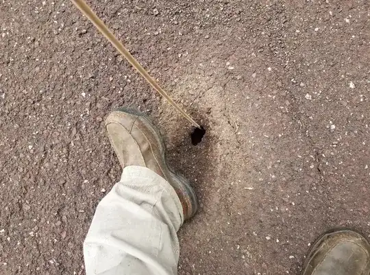

We recently moved into a new to us house. There are a couple of depressions in the asphalt driveway that I thought I should try to level with some bagged asphalt patch.
Maybe unsurprisingly, when I swept the dirt and loose debris out of one of them, I found that there was a hole straight through the asphalt and into a void in the soil below. I am thinking this is an animal burrow, since I have found another void just under the soil surface nearby which I was able to confirm is a burrow.
My thought is that I could break away an opening in the asphalt large enough to gain greater access, fill the cavity to the best of my ability with crushed stone and then cover with and tamp the patch material.
I realize of course that if there is a burrow that close to the surface, it may manifest in other locations over time which I'll have to address too.
Otherwise, does this seem like an okay plan? Or should I be looking to do something else? (Short of tearing up the driveway, re-grading and repaving..) enter image description hereenter image description hereenter image description hereenter image description here

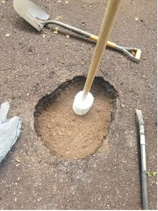

First, I used the chisel to lightly mark a perimeter outside the depression.
Then using the chisel & pinch point bar, I was able to open up the area and achieve fairly vertical walls. I wouldn't call them smooth, so certainly not as good as using a saw.
I dug down, clearing asphalt debris, base rock and some of the underlying stone & clay. Doing so I could follow the void (loosely filled with debris) down maybe 18" until it went underneath a small buried boulder. I'm now more than ever fairly certain it was a burrow. By this point I had removed 4 (or 5?) five-gallon buckets worth of material (asphalt, crushed rock, clay soil / stone).
Photo looking into the burrow under the boulder. enter image description here
I forgot to take pictures at this stage, but I filled the burrow with crushed stone, packing using the pinch point bar.
I then added & tamped down the paver sand. enter image description here
Followed by crushed stone, up to a level just below the existing asphalt. enter image description here
I then added 1 bag at a time of the cold patch, tamping flat between bags (I actually didn't need the whole second bag and used the rest elsewhere. enter image description here
