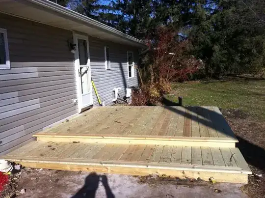

I thought this would be a fun thing to do (and perhaps set a precedent on diy.stackexchange.com)- post a picture with the results of my question.
Thanks to the tips here on this question, as well as another I asked, I have completed my deck project. I ended up with what was described above- a ground-level deck, mostly on the slab. I took Shirlock's advice, and went with an 8" deck block at the two corners not on the slab. I compacted the earth a bit with a hand compactor. Since the deck is not attached to the house, if there is some heave, it wont do any damage, and I can always dig some concrete holes under those two corners next spring if it turns out I need them. So, without further adieu, the finished deck (yes I realize we have some funky siding.. spring 2011 project ;) ):
Deck
MarkD
  • 5,095
  • 61
    Awesome job! I especially like the mitered edge banding -- it really makes for a professional-looking job! Thanks for posting this and I agree it sets a great precedent. – Mike Powell Nov 12 '10 at 17:19
  • Thanks Mike! I thought that edging the deck would finish it off a bit better than just running the planks to the edge. In the spring we'll stain/seal it and probably put a railing on the two outside edges, and I'm thinking of building in a bench along the side furthest back in the picture. – MarkD Nov 12 '10 at 17:57
  • +1 Nice job! And I like the idea of adding after-pictures, I've got one of my own. – Steve Jackson Nov 12 '10 at 18:42
  • Great job. love the picture frame detail around the edges. Need a job? LOL I agree, a nice seat would be an awesome detail, both functional and attractive. You also may consider putting a shallow french drain or band of crushed stone around the parimeter to keep water away from that nice looking wood. Congrats on a fine looking deck. – shirlock homes Nov 14 '10 at 11:57
  • Thanks Shirlock. The step you see in front, goes all the way to the slab to give it a finished look (and that entire step is over the concrete slab). The raised portion of the deck behind, is actually on posts, raised about 2" off the slab/ground (so other than at the base of the posts, it isn't touching the ground). We plan on putting nice plants/mulch around the whole thing in the spring. – MarkD Nov 14 '10 at 22:04
  • This great and I want to do something very similar. Did you ever put the rails up? –  Jan 27 '13 at 17:42
  • We haven't yet- as the deck is only about 6-8" above grade, there isn't a safety issue, and while it would look nice, has not yet become a priority. – MarkD Jan 31 '13 at 00:59
