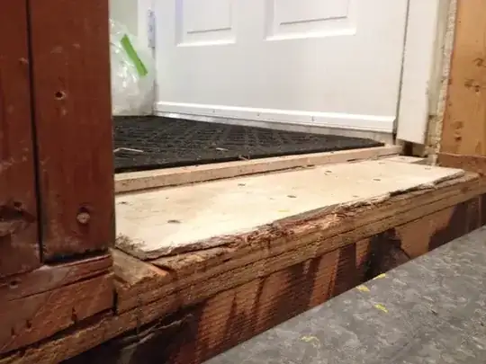

Consider a sillcock
I mistook this for a sillcock, because the faucet is not at an angle like a typical faucet, but square-on to the pipe (so the shaft can go down the pipe).
The sillcock is actually quite long and goes all the way into the interior of the house, where it's warm. The actual water valve is there. The purpose is to protect the valve from freeze damage. It will self-drain and is freeze-proof, if nothing is attached to it.
Sillcocks have certain rules about not connecting things to them indefinitely. Those can damage sillcocks. That's also why I thought you were having the problem I thought you were having. enter image description here
