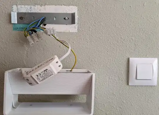

I have a bedside LED light embedded into the wall. When turned off, the LED are still at around 5%, not so bright, but similar to the fire exit sign you would see at the cinema. Immediately, I guessed power leakage via a capacitance effect, but I was yet unable to get rid of the 5% glowing. Any suggestions?
The symptoms are similar to LEDs stay on (very dim) when switch is off, except that the OP had night lights on the switches, I do not.
Here is a photo of the overall system: mains supply, wall switch, appliance, and shunt towards the switch + another of these appliances.
Overall system
The appliance
It seems to be made of a series of LEDS (12 n.o.) which are connected to an AC/DC transformer. This transformer sits at the back of the structure of the lamp, where it is embedded into the wall. It indicates "LED Power Supply" and is also TUV certified, so I take it this is a high-quality device. The LEDs panel is bolted into the structure of the lamp so the two most likely came together. It also looks like the transformer came already wired to the LEDS panel, but I could not confirm as I moved in whilst they were already installed (new).
The transformer is rated "AC 220-240V 0.1A" Neutral + Live, and "DC 10-21V 300mA (CONST)". It also says "No-Load: 32VDC Max Prated 6.3W" (not sure what this is for?).
Transformer ratings 1
Transformer ratings 2
The power supply
We are in Spain. Grid supply for the flat is AC 130V x2. That is, no neutral, 2 live cables of 130V each when measured against earthing; happens often in Spain and other parts of Europe I read.
Additional info
This is not a fluorescent effect: when I disconnect the house from the grid, it stops glowing immediately.
The fact that the lamp is a bedside light is mostly irrelevant: the lamp is activated by a wall-mounted switch, like any typical ceiling lamp would be. This switch is unfortunately acting on only one of the two phases. Changing this switch would be ideal, but unfortunately very difficult: (i) not easy to find a dual-wire wall switch, (ii) I would need to rewire an extra cable into a duct which is already crowded, and (iii) the extra shunting would have to be done behind the embedded light and there isn't a lot of space there either.
Note I have this same 5% power problem with all LED appliances of the house: 2 bedside tables and 3 ceilings mounted appliances of another brand. For obvious reasons, the bedside appliances are the most annoying ones and my priority right now.

Disconnecting one of the AC cables
I ran a series of tests by disconnecting one of the cables plugged at the driver's AC terminal under various configurations:
  1. Disconnect the live cable that goes to the wall-mounted switch -> the LEDs glow 5%
  2. Disconnect the regular live cable and turn the wall-mounted switch ON -> the LEDs glow 5%
  3. Disconnect the regular live cable and turn the wall-mounted switch OFF -> the LEDs are at 0%.
Whether the connected/disconnected cable was on the N or L terminals of the driver had no impact.
I concluded the problem was not with the electrical installation of my home (beside having to half Lives instead of L+N), neither caused by a bad quality switch or induction effects.
Connecting both AC terminals to the same cable
I connected both ends of the driver's terminal (N and L) to the same live wire. That is, I short-circuited the driver. To my greatest surprise, the LEDs were at 5%!
It becomes clear to me that adding capacitors, resistors, or anything on the AC side is hopeless. I believe what is happening is a capacitance effect directly within the LED driver; most likely permitted through the coil of the voltage transformer.

The LED driver is defective. Contrary to the statement, "It […] is also TUV certified, so I take it this is a high-quality device," the conformity certifications this device received from TÜV Rheinland do not imply functional quality, but merely operational results within a safe range for EU ElectroMagnetic Compatibility and Low Voltage Directives.
