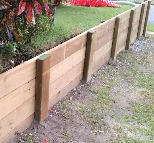

The back of my property has a couple of drops down toward the final elevation, sort of a terraced effect. The first of those drops I retained with a timber retaining wall in order to make the backyard area closest to the house a level space. The retaining wall is built using 4x4 uprights set to frost depth (~28") and 2x8 horizontal members attached to the load side of the posts. Excavation was limited to "scraping" the little slope to remove the remains of a flag stone wall from years ago, and to remove a large bush that had grown into the slope. So for most of the length, little soil was removed, save the bush which required a 5' or so round excavation to fully remove. The wall was then built out 2-3' from the previous slope and then back filled to bring everything level with the rest of the yard to the house. This was all completed before the end of September 2020.
My wall is the same as this, only the posts are square: enter image description here
The height of the wall varies along its run, but is never taller than 36". That means there is probably about 3' or so of disturbed (back filled) soil along the wall's length, and an extra 2' or so in a semi-circle where that bush was.
