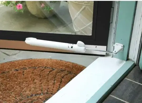

Try this too. Though it indicates open 90 degrees, but actually it may open up further.
Wright Products V150WH Heavy Duty Pneumatic Closer enter image description here

  • Thanks for that link. I was worried that a commercial one wouldn’t be viable do to the typical space constraints between the storm door and entry door, but this low profile closer might solve that issue. – George Kendros Jun 07 '21 at 23:43
  • You are welcome. Here is a web page that leads you to the 2nd product "Wright Products V150WH Heavy Duty Pneumatic Closer", https://www.bing.com/search?q=Wright+Products+V150WH+Heavy+Duty+Pneumatic+Closer&cvid=c0dad2f04c6f463dad338846414a0516&aqs=edge..69i57j69i60.2918j0j9&FORM=ANAB01&PC=LCTS. Note there are many comparable products that you can check out yourself. – r13 Jun 08 '21 at 00:17
