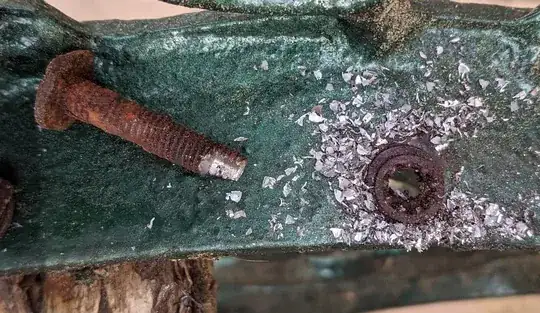

Update:
Drilling successful! One down, 23 to go...
drilled bolt

Looking at the condition of the nut and the minimal profile of the head, I'm afraid the better question may be "how do I get these out with minimal damage to the wood?"
I'd take a drill to the end with the nut. Hold the nut with pliers if the nut-and-screw assembly is prone to spinning. Choose a drill slightly larger than the screw itself. You can either drill all the way through the nut until the remnants of the screw and nut are completely separated, or drill most of the way through and then hammer a punch or nail set into the drilled hole until the screw/nut shears away.

I would use a small grinder ( Dremel) with a cut-off wheel and cut the nuts off.

Normal flathead screwdriver in theory
I believe these are simply used to make it easier to apply a flathead screwdriver with at most 90 degrees of turn adjustment needed. So in theory you can just put a flathead on it, a spanner on the square nut, and you're done.
In reality, better with a Dremel on the nut
Considering the level of rusting though, it's highly unlikely you're going to get anything to part company. Most likely the screwdriver slots are going to give way, or for a second possibility the head could shear off. I'm with @blacksmith37 here - the best solution is to simply cut the nut off, and then use something of the right diameter as a drift to knock the bolt out of the front.
