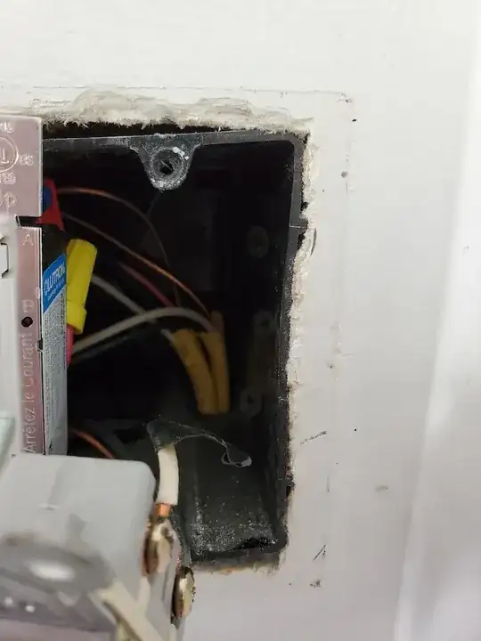

Edit: Adding some pictures...
  • The boxes The boxes (the panel is a foot or two to the left)
  • The cables leaving the junction box for the switch box In the junction box, the cables leaving for the switch box
  • the incoming cables in the switch box The incoming cables in the switch box

  • Thanks! This makes sense to me. I just added some photos...is the only thing between me and proper wiring about six inches of smurf tube around the two cables going from the junction box to the switch box? (Which almost certainly isn't there, but might be if I could open up the wall...) Or is the fact that they have their own sheathing also a problem? Side note - the writing on the electrical panel indicates that there is an in-wall timer on both circuits. I replaced one in-wall timer with the smart switch you see. The single-pole switch was therefore not initially planned? – cw94706 Jun 09 '21 at 15:05
    Almost. If it is really 6" (or even a few feet) between the boxes, then the conduit (smurf tube) solution makes a lot of sense. But what you do then is **not** put the *cables* through it, but rather get some individual wires (THHN - can't just shuck the cables to get wire for this purpose) to match all the necessary connections. If you do that, you can actually get just black & white & green, because you can use black in place of black & red - but label all the black pieces using colored electrical tape to make it clear what goes where in case you need to do any future repairs/changes. – manassehkatz-Moving 2 Codidact Jun 09 '21 at 16:26
