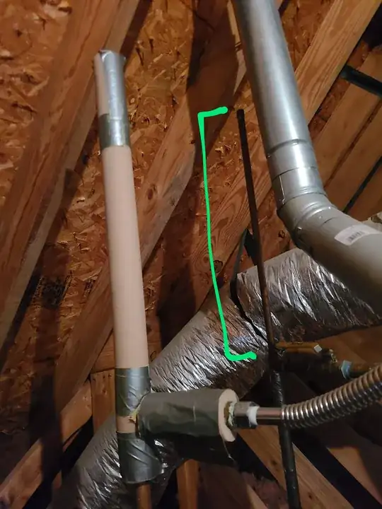

Here is a picture showing a clearer angle of the clip holding the pipe onto the joist, and of the right-angle turn at the end of the straight pipe.
clip and turn
Here's a picture of my patch, with my finger resting on the pipe for scale.
patch
Here's a picture of the dead leg on the cold supply side. Pictured is another dead leg wrapped in insulation for the hot discharge side. This setup is replicated for the water heater on the other side of the house.
dead leg

  • To be clear, my patch is nowhere near the dead ends, and the dead ends are not causing any noise (even if they swayed, there's nothing close enough to bang against). The hammering only happens when the irrigation valves open, not close. But I will try to secure the pipe. – John Freeman Jun 21 '21 at 21:22
  • @JohnFreeman ok good info, so then I don't know what's hammering. If it's hard to anchor those pipes and you are not sure, you can just do apply a temporary anchor to see if it reduces the noise, which would give you a hint. Is your noise a bang-bang-bang or a ratatatatata? Maybe the pipe is bowing & straightening with varying pressure & flow, and rubbing through an opening. – P2000 Jun 21 '21 at 21:34
  • I've added a video and picture to the question, to see and hear the hammering. – John Freeman Jun 21 '21 at 23:43
    good. That could also sound like a sprinkler valve that is soft/unstable, perhaps due to shockwaves reflecting in the sprinkler tubing. Was the valve also exposed to frost? Where is the valve? is it a solenoid (electrical), and are you operating a switch in the video? If so, is there a shutoff after the solenoid that you could close to see of the sound persists? I doubt the patch is the issue. – P2000 Jun 21 '21 at 23:59
  • I don't think it was cold long enough for the ground to freeze. The valves are very far away, measured in length of pipe. The first is probably 100 ft away. They are solenoid. In the video, I'm using an app to remotely open the valve for the first zone. There are no valves after each solenoid. – John Freeman Jun 22 '21 at 19:34
  • @JohnFreeman and when you switch it on what do you hear at the valve, clicking perhaps? Just to confirm: there was frost, you patched, and only after that did you operated the valves for the first time and noticed the sound. Are you capable of installing a bladder or spring hammer arrester near the valve? What kind of pipe/tubing do you have outside? Are you willing and able to replace the valve to eliminate causes? – P2000 Jun 22 '21 at 20:23
The damaged section of pipe may be creating turbulence of a frequency at or near a resonant frequency of the unsecured pipe. If the sprinkler valves open much more quickly than ordinary manual manipulation, this could set up time varying turbulence.
