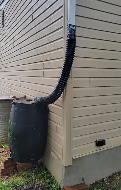

I am looking to get a new patio put in my back yard, and my local township laws require use of rain barrels if you have over a certain amount of impervious surfaces on your property.
I have this current setup, with a plastic flexible spout piece that sits on top of the barrel. This works pretty well until heavy rain storms, where the water coming down the spout is just too much for the flexible piece to handle. Eventually, the weight of the water bends the flexible piece to the point where it falls off the aluminum piece, letting all the water fall straight to the ground.
Gutter
Looking around, there doesn't seem to be any kind of aluminum downspout pieces that "bend" around a corner, most pieces all seem to be straight in some fashion. Moving the rain barrels is difficult because the land isn't quite level on the side of the house where the down spout comes down, and the black barrel is shorter than the tan one (hence why its propped up on bricks). It needs to be slightly higher/level with the tan one in order for the connecting overfill tube to properly drain into the tan barrel once the black one is full.
What can I try to get a more permanent solution that won't fall off during heavy rain storms?

    If the patio is on the downspout side, you shall place the barrels under the patio and let the downspout penetrate through the deck to drain directly into the barrel. The unleveled ground shouldn't prevent you to do so. – r13 Jun 26 '21 at 16:44
    @r13 the planned patio isn't on this side of the house. The patio is also going to be concrete, in the ground. So I don't think that's an option for me. The rain barrel law states they must be on the property _somewhere_. This is really the only spot they'll work on my lot. – Timothy G. Jun 26 '21 at 16:46
    The easiest way is to move the black barrel closer to the corner and keep the flexible pipe as short as needed to make a steep slope. – r13 Jun 26 '21 at 17:03
  • Depends on the size of your downspout, this transition may buy you a little offset space to attach a 6" diameter pipe, or a short flexible bend connects to the rigid pipe. There is 3 1/4" x 10" - 6" transition available (BR-411). https://www.kitchensource.com/range-hoods/br-optional.htm – r13 Jun 26 '21 at 17:38
    Maybe I'm missing something here, but is the issue that the black flexible pipe keeps falling off? If so, can you use a few sheet metal screws to screw it into the aluminum piece? – Joshua Dwire Jun 27 '21 at 04:30
  • Admittedly, screws will probably help - fastening the flexible piece to both the downspout and the barrel, but I haven't tried that yet because having seen how much the flexible piece bends when filled with water, I wasn't sure if screws would really fix the problem. It would bend so much that I think the water would struggle exiting the flexible piece, possibly missing the barrel in the process. – Timothy G. Jun 27 '21 at 14:43
  • Excavating and burying weeping tile is probably the most permanent solution if you don't have need for the water in the barrels otherwise. – J... Jun 27 '21 at 14:44
    @TimothyG. Screws would fix it. It's not coming apart because of the weight of the water sitting in the pipe - it's because of the long drop. The water falls down the white downspout and picks up speed as it does, impacting the corrugated sides of the black pipe and continually hammering it until it pops itself off. If it was fastened with screws that wouldn't happen. – J... Jun 27 '21 at 16:58
  • Why can't you level the ground around the corner using a shovel or some bricks/pavers? That seems like a much easier solution than trying to find nonstandard drainage products for a weird barrel position. – TylerH Jun 28 '21 at 14:04
  • @TylerH I think my plan is to try and level the ground out some and move the barrels. I have the bricks, and some flat stones too. I think I am going to try and move the black barrels to close to under the downspout, with the tan barrel around the corner of the house, connected with a automotive radiator hose. And also some screws as noted... – Timothy G. Jun 28 '21 at 14:56
  • @TimothyG. AFAIK it's not supposed to "fill" with water. The water goes through it and comes out the other end. If it fills up with water something is stopping the water coming out. – user253751 Jun 29 '21 at 14:01

Three downspout elbows. One takes the spout out past the edge of the house, the other connects to it to take it around to the barrels, the last drops it into the barrels.
Rectangular downspout elbows come in two forms - you'll need a couple of one type (bends the narrow way) and one of the other (bends the wide way.)
You also need brackets to attach them to the house so that they don't fall apart with water in them.
You can also do it with round smooth pipe elbows, starting from a rectangle to round adapter at the end of the downspout.
Or you could use a bunch of plumbers strap and screws to properly attach the corrugated thing to the house so it would not fall out. But smooth rigid pipe will flow better and clog less.

Move the black barrel!
You already have it on bricks. How much more level do you want than bricks? Place the base on the ground and dig out one side until your spirit level shows the base is level. Then put the black barrel directly under the downspout. This appeals to me because of the wonderful cheapness. You have everything you need already.

If you are dead set that the barrel stay put, make a more durable turn. It is the energy of the falling water in the turn that pulls the flexible piece off. I would try this.

As Joshua Dwire mentioned in a comment, most of these flexible gutter lines have one or two spots where you can drive a screw through and anchor them to the metal downspout. That should prevent it from disconnecting.
You replied, saying:
These flexible downspouts aren't designed to support weight. You can run them horizontally along the ground, but not in mid-air as shown in your picture. I recommend attaching the flexible downspout as high as possible, so that it can stay more-or-less vertical throughout its entire run. Even the rigid metal downspouts try to avoid horizontal runs as much as possible. If you can move the attachment point twice as high as it is currently, the average slope will be twice as steep and you shouldn't have nearly as much bending.
If the horizontal section is unavoidable, try to place it at the top of the rigid downspout instead of the bottom. The water won't have as much downward kinetic energy just below the gutter and shouldn't stress the flexible pipe as much.
You don't show what your gutter/roof looks like here, but another option is simply to seal off the existing downspout and install a new one above the rain barrel. You'd cut a hole where you want the new downspout to go, install a flange like this one, seal around the edges, and then attach the downspout. There's an existing question that covers sealing off the old opening. This solution is a bit more work, but still DIY-able and should give the best-looking results.

You already have a square to round adaptor - going from the existing downpipe to the corrugated , troublesome one. Surely plastic pipe is available where you are, and it's so much easier to get round corners with round plastic pipe. Swan-necks, 135 and 90 degree bends will get you there, and it can all be bracketed to the wall. Being smooth inside will also solve the flow problem.
Moving the barrel closer to the corner of the house will also help - and use less pipe.

As a temporary, and perhaps permanent measure, you can use pipe straps (metal, plastic, nylon) screwed to the wall to support your existing corrugated plastic pipe in a couple of places. Even if you go with the excellent "AB" answer you should still support the pipe so why not start with just supporting what you have, if in fact the only problem you are trying to solve is that it lacks support? You should also screw that firmly to the downspout with three screws.
