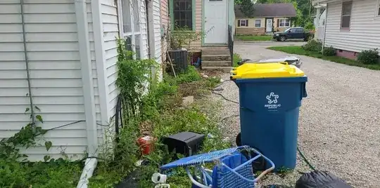

On this side of the house, it's just a few feet to a gravel driveway. Problem?

I would not particularly seek out clay, but yes, you can fill next to the house, which often settles because it was dug up to put the foundation in, and filled, and then settled over a winter or two (or 102, but mostly the first one or two) and was not re-filled to maintain the grade.
Limit the extent to which you dig out, unless you are willing to come back in another year and re-fill on top after what you dug up re-settles. It's very difficult to mechanically compact to the extent that going through a couple of freeze-thaw cycles will, so it's generally easier to just let winter work for you, if you can allow it the time.
If you do dig out much, you can set an impervious later (such as XPS foam) at an angle away from the house underground, before filling on top, as an "underground roof" to move percolating water away from the house. But that's going beyond the basics of just making sure the surface grade is correct.
All you need to set surface grades away from the house is a straight board, a 4-foot level, and a 1/2" block for one end (the one away from the house) of the level. On the side with the short distance to the neighbor, slope out and then front or back (or both) depending where your water is to end up.
