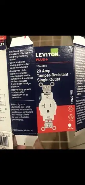

I recently replaced a 20 A 250 V single outlet with a 20 A 125 V single outlet so that I could use it for my microwave in the kitchen. The original outlet had two gold screws and a grounding screw. However, the new outlet has one gold screw, one silver screw, and a grounding screw. I hooked the new outlet up in the exact way the previous outlet was installed but when I went to plug in an extension cord, it made a popping noise and shut off my main breaker. Should I try to switch the wires? Or am I using the wrong replacement outlet?
Outlet Outlet packaging

    Never, ever, ever replace an outlet with one that has different shaped pins. The shape of the pins is dictated by the voltage and current that the outlet is rated for. It's there to prevent you from plugging in an appliance to an inappropriate outlet. Here you have deliberately defeated a safety feature that tried its best to stop you from connecting your microwave to those two wires. You have likely now destroyed your microwave - you're lucky it wasn't worse. Either do your research **before** you start touching wires or *call a professional*. – J... Jun 28 '21 at 12:13

    So you are changing it to a 120V outlet, but it still has the exact same 240V electricity? That's a problem – user253751 Jun 29 '21 at 08:59

You can't do that! Don't switch any wires. That a 240 volt outlet, a 120 Volt line to each of the two brass screws and a ground on the old outlet. You plugged a 120 Volt appliance into a 120 Volt outlet wired for 240 Volts...... and probably ruined the microwave in the process.
You need a neutral, white wire and one of the existing hot wires. Is there one in the outlet box?. If not, you need to replace the cable with one that has a neutral or pull a neutral in the conduit if you have conduit or re purpose one of the hot wires and change the breaker to a single pole. You could also put the old outlet back in and get a microwave that's straight 240 Volt... since you probably blew out the existing one.

The outlet is just a connector - it just lets you plug in cords to the electricity supply. It doesn't actually change the electricity supply. You still have 240V electricity going to this outlet, even though it's now a 120V outlet.
The difference between a 240V outlet and a 120V outlet is the shape of the holes. They have different shapes so you can't accidentally plug in the wrong things. You can't plug 120V stuff into a 240V outlet and you can't plug 240V stuff into a 120V outlet.
Except that you changed the outlet, so now you can plug 120V stuff into 240V electricity. And it goes bang. Don't do that.
If you want 120V then you have to change the wiring so the outlet is getting 120V electricity instead of 240V. If there's more than one outlet on this circuit and you still want the other ones to be 240V, you'll need to add a new circuit; otherwise you should be able to convert the whole circuit to 120V, reusing the existing wiring, by rewiring it at the switchboard and replacing the outlets. Since you've indicated you don't really know what you're doing, I would hire a professional electrician.
