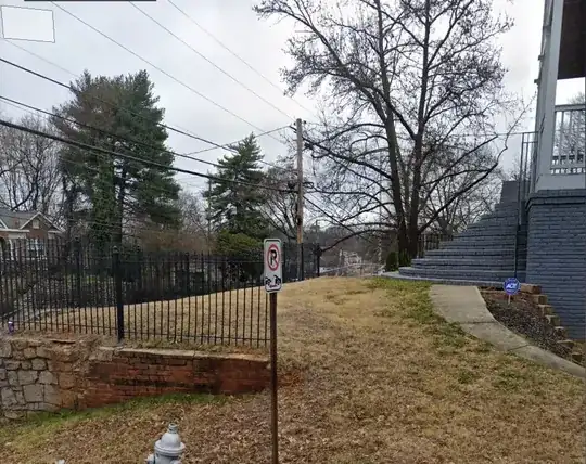

We live on a busy street with sound of tires and revving engines. We were wondering if hedges could help reduce the sound that comes into the house? if not, what other alternatives can we try? We already got soundproof curtains but it's still loud. Below is a photo of the front yard and the house.enter image description here

  • I think that since the road is so low, that a hedge would visibly block traffic from most of the front windows. If that's the case, they will also dampen sound. The dampening is a factor of mu and the frequency, so it would work better on tire noise than engine noise. I would expect 2-3DBs of loss from a thick hedge, much more when it's covered in snow (if you choose an evergreen). Replacing the iron fence with wood could give you several more DBs. It will never be quieter than what you hear in the backyard though, be realistic. – dandavis Jul 03 '21 at 07:53

From the photo, it looks like there's not a lot of distance between the road and your house, and worse, you're well above road height.
If there were more space,and local codes allowed it, the best barrier is a berm. Even a 4-or 5- foot high berm will deflect a lot of the sound upwards and away from your house. Add a solid fence on top of that and it'll get even quieter.
