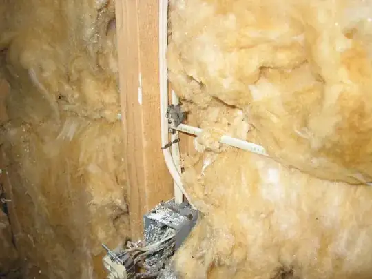

Suddenly some of the outlets supplying our table lamps quit working. I checked the breaker and it wasn't tripped, but I reset it anyway. Still no power to some of the outlets. So I turned off the power and pulled out the outlets. Tested for continuity and found there was no continuity between the operational outlet and the dead one. What could cause this?

Rodent damage is not often discussed here but it's real. Fortunately the outlets on the wall that failed were on a shared wall with the attached garage. I opened up the wall on the garage side and found this little guy, electrocuted in place. He'd chewed thru the cable, broke the hot or neutral wire, kept going until he "made contact". So when you experience a weird failure that can't be attributed to a tripped breaker, tripped gfci, loose connections on switches or outlets (particularly the notorious back-stab outlets), it could very well be rodents such as mice, rats, squirrels, etc.
Based on some comments, I'll edit my own answer:
To fix it I simply ran a new cable between the two outlets, no splicing involved. Fortunately it was an easy and accessible path to do that. And YES!...SPEC GRADE outlets, no back-stabs, like Harp says. In fact, I believe I replaced most of the outlets in that home with spec grade, but that was 20 years ago, so not sure. In my new home, I wired all convenience outlets with 12ga, 20amp spec grade outlets. That's how you do it!

    The fix gets tricky. Can't splice in situ except with special connectors. Better alternative, depending on the (currently removed) wall material is to shift the receptacle up to just above the damage location. Or maybe add a junction box there and add an extra receptacle while you're at it (rather than leaving it with a blank plate). – manassehkatz-Moving 2 Codidact Jul 16 '21 at 17:44
    Stuff happens. I had a circuit have intermittent issues that housed a micro... The breaker would trip once a month and then be fine... then every week then every other day. Thought there was a load issue... did troubleshooting for way way too long... What it came down to was the romex (good quality copper) was coming from attic, came down and did a 90 to the next stud to come out for the micro... It was only like an 8' run. Well it looks like that 90 kinked it and eventually with years of strain it just failed... looked perfect to eye (other than bent) – DMoore Jul 16 '21 at 17:56
    @manassehkatz-Moving2Codidact Tricky indeed... all three cables are chewed. Maybe two of those inline Romex splice kits and move the outlet box up... and get rid of the backstabs. – JACK Jul 16 '21 at 18:17
    @JACK LOL, a run of new cables between the outlets/switches , no splices. Also, LOL at your comment on the mouse making me fix the backstabs....funny! – George Anderson Jul 16 '21 at 18:45

    To respond to various comments: I did mention lose connections, which would include lose screws and lousy back-stabs. The fix was to simply replace the cable entirely from one outlet to the other...no splicing involved. Harp: I didn't wire this house, and I certainly replaced the outlets with spec grade---no back-stabs. In fact I think I replaced nearly all the outlets with spec grade, but this was 20 years ago, so I don't remember. I'll edit my answer based on your comments, thanks! – George Anderson Jul 16 '21 at 18:33
    @George sorry... I didn't realize you were the asker *and* the answerer! Confused me! – Harper - Reinstate Monica Jul 16 '21 at 18:39
    @Harper-ReinstateMonica No problem. This is one of the few times (if ever) I did this. I understand it's encouraged by SE, but I was going thru some old pictures on my PC and ran across this one. Thought I'd share because I think rodent damage is understated here. Thanks for the comment, we're good. – George Anderson Jul 16 '21 at 18:43
