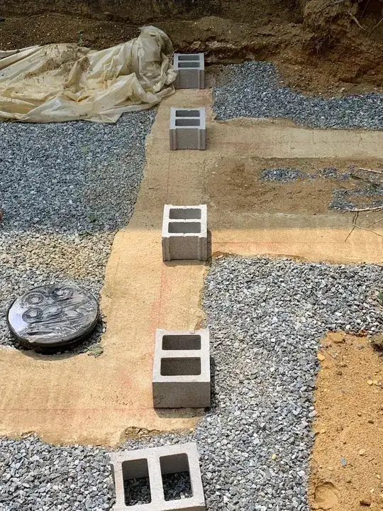

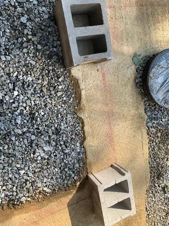

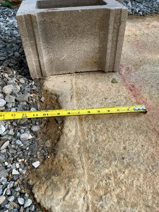

I'm having an addition put on my house with a full basement. The contractor poured the footer and is getting ready to do the foundation walls. He marked the lines for the walls, and I couldn't help but notice that one corner is cutting it very close where the block actually overhangs part of the footer (see pics below). Also note, they didn't use a form for the footer and just poured it into a trench in the dirt, so the edge is rough and some of the concrete supporting the block is just over-pour and not solid footer. It looks like only about 7" of the 12" block will be fully supported by the footer!
Is this footer going to work? Is it to code? If not, what needs to be done to fix it? Can they just dig out more to the side to add to it? Does the part of the footer, or even the whole thing, need to be replaced?
footer with block lines footer with tape measure from line view from above going back to existing structure
Edit More details about the addition: The addition is 15'x30', with 2 15' walls and a 30' between them. (The other 30' side ties into the existing structure.) The corner shown is the end of one of the 15' sides. About 2/3 of it will be 2 stories, including the space above the corner in question. Wood framing with 2x6 external walls will sit on top of the foundation. Greater Philadelphia, PA area.
Update Spoke to my GC, and he confirmed that his concrete subcontractor screwed up by about 6-8 inches. They will be digging the difference out today and pouring additional concrete. But the question still stands: Is this a good, code-compliant solution that won't give me trouble 10-20 years down the road?

  • Are you sure which side of the line the blocks go on? What size is the addition? Where is the location in the world? Off hand would say it is cheap work and might not be code, but it depends if addition is a covered entrance way or a single/multi story building. – crip659 Jul 22 '21 at 15:23
  • @crip659 - more details about addition added. The block definitely goes on that side of the line. The other end of the footer (next to the existing structure) has 2 lines with the block sitting right between them, accurately centered on top of the footer. – djs Jul 22 '21 at 16:09
  • Will let the experts on here answer, but do think you should be concern. Has building inspector check it yet? – crip659 Jul 22 '21 at 16:17
  • @crip659 - Inspection schedule calls for footer forms before pouring (which passed), then foundation walls prior to backfill. Of course, changing the footer after the walls go up will be much more difficult! I'm hoping to have this addressed before they start the walls, which may be later today. I have a call into my GC... – djs Jul 22 '21 at 16:23
  • You are paying them, so you can stop the work till you have the right answers to your satisfaction. Can you confirm if forms were used or just a trench dugged out? Blocks do have to be on footers themselves, not on any over flow. – crip659 Jul 22 '21 at 16:34
  • I do think that either the lines are misplaced or your reading the lines wrong. Blocks should be inside of the tiny ridge of over-pour. If not, someone will be shovelling. – crip659 Jul 22 '21 at 16:51
    This is just a comment... Whenever I have worked with a crew and used blocks - above or below grade... The snap line was used to center the blocks not as the edge, one way or the other. – DMoore Jul 22 '21 at 17:55
