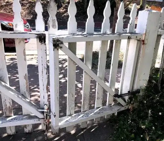

Our house's front yard is separated from the street with a low picket fence with a spring-operated gate. The latch of this gate has been consistently problematic because it is exposed to the weather and takes a lot of force and vibration from repeated openings and spring-assisted closings. I've tried many solutions over the years. I'd hoped that my last attempt—fat metal screws wrapped in plastic screw anchors—was going to last, but sadly one of the screws failed today. (See pictures below.)
What's a good solution for latching this darn gate?
Note that the pictures below are taken from a weird angle (because the gate isn't fully closed) which makes it look like the striker bar is offset vertically from the latch, but in real life they're aligned.
Here's a close-up of multiple failed past attempts, including several broken screws, plus some metal bars intended to reduce up-and-down vibration. (Yes, I know we eventually need to replace, or at least repaint, our ugly fence, but I've been trying to delay that as long as possible!)
Here's the latest latch I used, with now-broken screws.

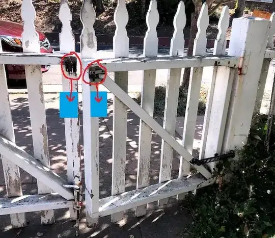

Build a stop strip so the latch doesn't take the force of slamming
Screw anchors in wood is not a good idea and in rotting wood is a waste of time.
I don't like how the latch bar catches the force of the slamming gate, and is built so it acts as a huge lever acting on two small screws very close together. That will never last so the solution is to take that function away from it.
  1. Install a stop strip along the vertical part of the left hand gate in this picture. Just a strip of wood attached to the left gate that will take the force of slamming the right one. Make it the full height of the gate, use six exterior-rated screws long enough to go almost all the way through the frame of the gate. Pre-drill. The stop strip should stop the right hand gate before the latch does!
  2. Move the latch a little lower to where the wood is undamaged as shown in another answer. You'll have to shim it slightly so the two parts align when the gate hits the new stop strip.
  3. [Added later after suggestion in comments] Now the latch bar will strike the latch lever before the gate strikes the new stop strip. Make sure the lever moves freely and is positioned and angled so it lifts with minimum force from the latch bar. You may need to grind it down a little so it pops up when the bar hits it rather than resisting the bar heavily.
Now, the stop stops and the latch latches and the old gate will fall apart before the latch next gets torn off it.

In my experience, screws into wood will eventually fail. A better solution is to use thru-bolts so that the threads can't pull out of the wood. You might consider using stainless steel or brass to cut down on corrosion.
From the photos it appears the wood is quite deteriorated. You will likely need to replace the damaged/weathered parts.

You could try using stainless steel bolts and go all the way through the wood from the front and fasten with a nut and lock washer from the back. That is going to be a lot stronger than a wood screw. Although from the condition of the lumber it may be too late for a good solid connection.

Another option is to relocate the latch slightly lower.
Get two blocks of wood and screw them onto the fence. Screw the latch mechanism onto the wood.
