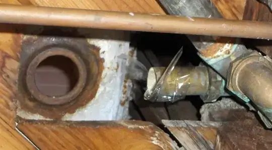

I went through the exact same series of attempts as you. A succession of drain wrenches, each stronger than the previous one, each of which eventually broke when enough force was applied.
Followed by the indestructible expanding knurled wing thing, using huge pipe wrenches for leverage, which eventually with enough force just dug grooves into the side of the drain but did not free it.
Here is what eventually worked, and took 10 minutes and almost no effort:
A $2 hack saw and a screw driver.
  1. Saw the trap off near the exit from the tub. Tie the tail piece with string to something nearby because later, when you are above, it's going to fall away.
  1. Saw two slits in the flange which is made of very soft metal then break away the piece you sawed off. Don't use a grinder or a dremel. You'll damage the tub. The flange is soft metal, a hack saw will get through it in 30 seconds.
  1. Bend away the rest of the flange and shove it through the drain hole. Remember you sawed off the tail? Now is when that string does its job.

  • Mine was on the second floor and I did not want to replace the whole stack because that would mean ripping open the living room wall. So the "in over my head" aspect was how to proceed from the situation you see in my last picture, knowing that anything I touch of the existing plumbing will probably end up destroyed. – jay613 Aug 03 '21 at 22:50
