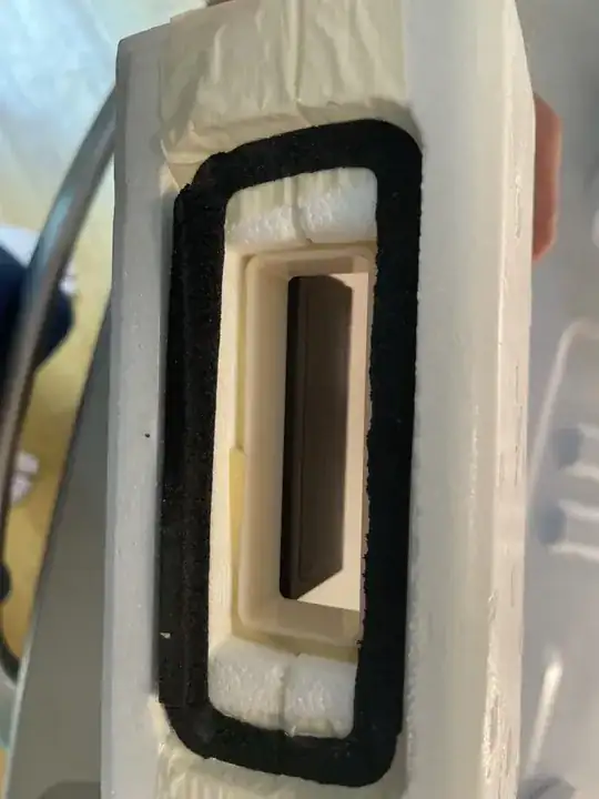

Update: So I took the other bottom drawer out and was able to unscrew the cover on the bottom housing. After taking it off, there was a styrofoam block there that seemed to direct air from a vent on the bottom (coming from the freezer?) to some holes in the back (that go up to the top shelf vent?). Interestingly, it also has a black device in it that has a smooth surface and is plugged in to a power jack. Not sure what that is, but it's not a fan. Here's a picture with the styrofoam block removed:
Bottom rear of fridge with housing and styrofoam block removed
And a photo of the block and black device inside: Styrofoam block
View inside the styrofoam block
Update: I'm not sure if it always did this, but when I opened the freezer and listened to the fan, it seems to be constantly running but occasionally "hiccups" - stops for a fraction of a second and then restarts. I'm not sure what controls this fan (the temp of the fridge?), but it would make sense if it was constantly running since the fridge thinks it should be at 39 degrees, but is reading 50 degrees. Not sure why it seems to stutter occasionally.

    There probably is a fan, which may have died. Or airflow (from either fan or convection) may have been cut off by a buildup of ice in the vents. Sometimes the fix is to simply thoroughly defrost the unit (after transferring the unit's contents to another fridge or to a chest filled with dry ice). – Hot Licks Aug 05 '21 at 18:44
  • Would that fan be in the bottom housing (in the 3rd picture)? I didn't look like I could remove that plastic very easily to check for ice - should I be able to access the ducting? – Doug Aug 05 '21 at 18:48
    Generally, manufacturers use the least-convenient arrangement possible. – Hot Licks Aug 05 '21 at 18:51
  • I was wondering the same thing. My office has a Samsung french door fridge. Its frozen at the rear of the bottom and 60 degrees at the top. – heyitsmyusername Aug 05 '21 at 18:57
    Unless your fridge doors have many windows they're not French. :) The door arrangement is probably irrelevant here anyway. – isherwood Aug 05 '21 at 18:58
    My understanding is that the industry lingo is "bottom freezer" if it's a single door on top (and freezer on bottom), and "french door" if the fridge has two doors that open out. At least Lowes, Home Depot, Best Buy and Amazon all refer to them that way. – Doug Aug 05 '21 at 19:40
  • Fan motor could be spinning but fan blade is loose on shaft and not spinning properly Thermostat may be bad leading to constant running and ice up of coil – Kris Aug 05 '21 at 22:14
  • I dealt with a similar issue recently, it was a combination of ice buildup and a very weak fan. The fan turned but after replacing the motor I could feel the difference in air flow, you should feel the air flow in the fridge. The drain would freeze and the defroster couldn't melt that, so it would melt the ice around the coils, and the water would have no where to go and just pooled up and froze in the air vent. – rtaft Aug 06 '21 at 13:26
