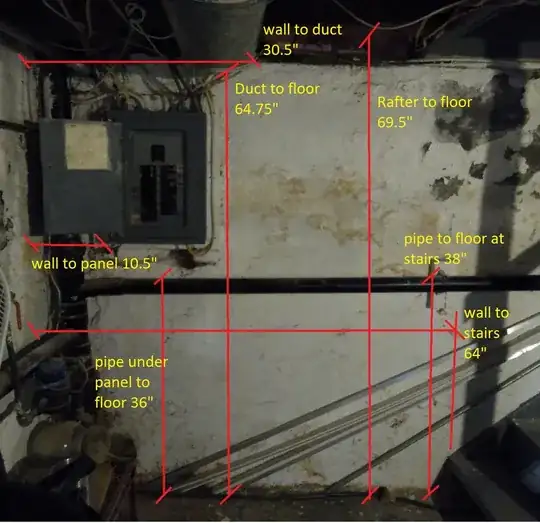

I also eventually want to put in a subpanel next to the Murray, with an appropriate generator transfer switch, and I'd like to move many of these expensive breakers to the new panel at that time. Here is the space I hope to use:
space for new panel
The black pipe may limit my panel height. Perhaps the Siemens SN or PN series, 100-Amp 30-space 30-circuit panel, about 28" tall, might be OK. The panels for sale are all plug-on-neutral now, but Siemens literature says their pigtail breakers will fit in their plug-on-neutral panels.
Does this plan make sense? Or do I have to do or use something different?
I understand that adding the subpanel may require a permit and inspection. But will the first phase, replacing all the breakers, require permit and inspection?
I am in New Jersey USA. The only major electricity user in the house is the central air unit. Stove, water heater, dryer, furnace are all natural gas.
Edit: adding another picture showing the panel wall, pipe and start of stairs, with dimensions. The drain pipe is 36-38" above the floor. The duct is 64 3/4" above the floor and 30 1/2" from the wall. The rafters are 69 1/2" above the floor. The open space from the stairs to the left wall is 64". The panel is 10 1/2" off the left wall. The front edge of the pipe is 4" from the wall the panel is mounted on.

Your breaker progression seems like an acceptable process, but a bit complicated. I do see a concern about the piping, possible overhead ductwork, and probable wire protection.
Everybody is usually pretty quick to identify that NEC 110.26(A)(2) requires 30" wide working space in front of panelboards, but if you keep reading you get to:
110.26(E) Dedicated Equipment Space. All switchboards, switchgear, panelboards, and motor control centers shall be located in dedicated spaces and protected from damage. Exception: Control equipment that by its very nature or because of other rules of the Code must be adjacent to or within sight of its operating machinery shall be permitted in those locations.
(1) Indoor. Indoor installations shall comply with 110.26(E) (1)(a) through (E)(1)(d).
(a) Dedicated Electrical Space. The space equal to the width and depth of the equipment and extending from the floor to a height of 1.8 m (6 ft) above the equipment or to the structural ceiling, whichever is lower, shall be dedicated to the electrical installation. No piping, ducts, leak protection apparatus, or other equipment foreign to the electrical installation shall be located in this zone.
So in your case it looks like you will need to fur the panel away from the wall to get in front of the plumbing. If that is ductwork overhead you may need to shift to the right, you could possibly interpret the duct as above the ceiling even though there's no ceiling. Then your wiring becomes kind of vulnerable to damage and may require protection up to ceiling height (like a removable panel). That does also appear to cause stairway access issues, I would ask your inspector if he would give exception for the ductwork above the panel at existing location.
So then this brings me back to your progression. If your purpose for mounting a separate panel for generator loads was related to vertical space available limiting the height of panels then that no longer becomes an issue if you fur the panel away from the wall. I would inclined to think it would be less work and lower cost to mount a single larger panel with an interlock for the generator. You would also benefit being able to buy PON breakers and avoid the pigtail entanglements.

  • The spacing info is illuminating, thanks. I gather that getting Siemens breakers is OK, and I should expect to be able to put them in a Siemens panel later. I added a picture with dimensions for the area. Does this influence the question of adding a panel vs replacing the existing panel? – Triplefault Aug 13 '21 at 22:15
    No problem with fitting the Siemens breakers. In fact for years electricians have been looking at the MP's and Q's side by side and knowing they were made by the same company wondering if there was any any difference besides the label. Siemens just finally made it official. I think the main issue is still the pipe below the panel, not sure what the rules read when panel was installed, but now when you replace or install a panel on that wall you will need to space the cabinet off the wall in front of the pipe, – NoSparksPlease Aug 13 '21 at 23:11
  • I added a dimension to the picture, the ductwork is 30 1/2" from the wall. I had not thought about height restrictions or if the duct might interfere. Assuming the township makes me fur out to clear the pipe and won't allow a second panel, will the duct require moving the replacement panel into the 33" space between the duct and the bottom of the stairway? – Triplefault Aug 14 '21 at 18:53
  • @Triplefault -- why would the township prohibit a second panel? – ThreePhaseEel Aug 14 '21 at 19:51
  • @ThreePhaseEel I think the inspector would likely say adding a panelboard in a room without adequate overhead working clearance (only 5'9.5") is not allowed. – NoSparksPlease Aug 14 '21 at 19:59
  • @NoSparksPlease -- this is covered by 110.26(A)(3) Ex. 1 – ThreePhaseEel Aug 14 '21 at 20:14
  • @Triplefault -- edited my answer to include the applicable exception – ThreePhaseEel Aug 14 '21 at 20:17
  • @ThreePhaseEel I see I missed that, deleted my edit. I don't see a similar exception for the dedicated workspace,, so the only available space is to the right of the duct, which could interfere with stairway access. I would still ask the inspector if he would give exception to dedicated space for upgrade at existing location – NoSparksPlease Aug 14 '21 at 20:32

That dedicated electrical space is going to be a pain
Your next problem is getting enough space out from the wall to comply with the NEC 110.26(E)(1)(a) spacing, as you'll likely need to either surface mount the panel over the furring strips (using cross unistruts or a plywood/OSB backerboard) or use deep (as in 2x8) furring to get the job done to Code. You'll also need at least 2 bays of furring in order to keep all the hardware at a reasonable height, especially given how tall modern panels can get.
The lack of the full 78" clearance, though, is not a pain point here. Since we aren't dealing with any equipment rated for upwards of 200A here, and this is an existing house, NEC 110.26(A)(3) Exception 1 applies to you:
Exception No. 1: In existing dwelling units, service equipment or panelboards that do not exceed 200 amperes shall be permitted in spaces where the height of the working space is less than 2.0 m (6½ ft).
