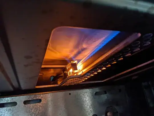

Yes, gas ovens light a flame to produce heat. The other answers saying to get this looked at are absolutely correct.
Here's a visual demonstration with my own oven, viewed from the under-oven broiler compartment (though everyone's will be a little different):
Oven before it starts heating (immediately after I set a temperature)
oven without flames The igniter is on but hasn't lit the flame yet
Oven when it's heating (10 seconds or so after I set a temperature)
oven with flames Now we're cooking with gas
According to Wolf Appliances:
Gas oven burners ignite in approximately 30 to 45 seconds [...]
If a gas oven or broil burner is not igniting or if a gas odor is present without ignition, discontinue use until repaired.

    In my gas oven the *broiler* flame is clearly visible as in these images but the main oven flame is beneath the oven floor and is not so easy to see, especially if the kitchen lights are on. The igniter is brighter than the flames and you can't make out what's what through the holes in the oven floor. If you turn off all the lights and know what you're looking for, you can tell that the flame is lit. – jay613 Aug 16 '21 at 21:46
