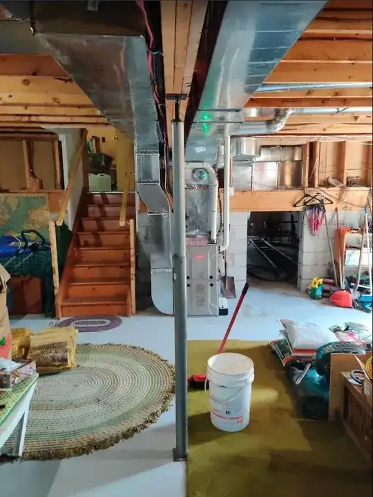

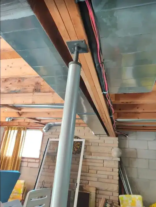

I have a (roughly 40 year old) house with a crawlspace, and then an upstairs above it - I believe this considered a 1.5 storey house. The upstairs is being held up by a long wooden support beam, and that beam is being held up by a metal pole but recently after getting forced-air HVAC installed, I found out it is not screwed into the wood support beam or to the concrete below. How dangerous is this?
I am thinking that for screwing the pole into the wood beam, we'd use wood screws, and then for screwing the pole into the ground, we'd use masonry screws? Does this sound accurate, and if so, does this sound safe? Is this something that would need to be reviewed by a structural engineer, or is this "safe" to do and very low risk? I think the pole is rated for 9000 pounds, if that matters.
Here is are pictures of the support beam and the pole: enter image description here

    Should be screwed. Don't want a bunch of teenagers seeing how far they can toss each other to knock it down. Then you are screwed. – crip659 Aug 18 '21 at 18:22
    Not addressing your question but it looks like you have two 4-inch or larger ducts penetrating your triple joist at the far end of it by the brick wall. Is that right? – jay613 Aug 18 '21 at 18:28
    @jay613, it looks to me like the ducts are routed up and over the triple joist. – Milwrdfan Aug 18 '21 at 20:27
  • @Milwrdfan I think you're right. – jay613 Aug 18 '21 at 21:32
    Don't trust the advice of random well-intentioned Internet people. Hire a structural engineer to come in and take a look. It _might_ be strong enough, or it _might_ be the cause of the upstairs part of your house collapsing one day. I sure wouldn't want to be in your house during a decent sized earthquake. – Dawood ibn Kareem Aug 19 '21 at 03:19
  • Since the post doesn't look like it's quite plumb, it's possible that its let the beam sag. I'd suggest pulling a string from one wall to the other, placing it right at the bottom of the beam along one side. If the string "moves" up the side of the beam anywhere, I'd suggest that getting an SE to take a look may be worth the investment. – FreeMan Aug 19 '21 at 16:34
  • @FreeMan - I agree but I didn't want to assume because of angled pictures. Also I completely disagree with Dawood's comment. There is nothing that indicates the beams aren't strong enough. His comment getting 14 upvotes right now could be made by practically any house that isn't using i-beams... Also if it is not plumb and needs to be adjusted you must do this over the course of time (usually one turn a week), not all in one day. – DMoore Aug 19 '21 at 18:37
  • As is, that looks like a disaster waiting to happen. Hire a real licensed engineer to determine what needs to be done. Although the solution may wind up being simple, this looks like it requires a professional and comprehensive evaluation. – End Anti-Semitic Hate Aug 20 '21 at 11:05
  • GB540 brought up a good point in his answer. It looks like this beam is made up of several shorter lengths of 2x. There's nothing wrong with that at all, however, it _appears_ that there may be places where 2 boards end at the same spot. Is that the case anywhere, or is it just an artifact of my bad eyes and a small picture? – FreeMan Aug 20 '21 at 17:59
  • What is the span length to the right and left of the beam? It looks like an addition to jack the floor up which has deflected. The beam end looks like loosely sit on the edge of the fireplace or chimney, the design was improperly done. I second @Dawood's advice - consulting with a structural engineer. – r13 Aug 21 '21 at 20:22

First that post is not carrying the load of the whole house. The beam is and the beam is attached on both sides. The post's job is to keep the beam from sagging and act as a point load.
I would not leave it like that for sure - and in my area there is no way in the world it would meet local code. Always have to be secured on both ends by at least two fasteners.
I would put a couple of big headed screws on the top plate and pop a couple ramset nails in the bottom. (MAKE SURE THE POST IS PLUMB BEFORE SCREWING!!)
Remember these posts are really strong for vertical forces... not horizontal.
What could happen if you don't secure it:
  1. Someone slams into it and knocks it out of place. At that time you find out that the beam was not really the right size, it starts creaking, 20 minutes later you hear cracking, your house caves in (I am kidding but hey could happen).
  2. Someone knocks the bottom of it. It seems fine. In actuality it's over 1-2" throwing off its angle. Now the beam starts sagging by 1/8" to meet the post... The wall above it lowers by 1/8" over a period of time and you notice small cracks in your drywall along the ceiling.

  • Also if it is off plumb it's easiest to temporarily support the beam with another telepost while making the adjustment. – Myles Aug 19 '21 at 15:57
At least in the area where I live, that type of support post is used when a house is modified (wall was removed, to prop up a sagging beam, etc). If the house was designed to have a support post there, the post would either be the same type of wood as the rest of the frame or would be a solid (not adjustable) metal post. The lack of screws/bolts on either end reinforces the notion that this support was added after the fact.
What I don't see in your pictures are any markings on the concrete around the base. Support posts that are bearing significant load need to be placed on top of a footer. Since the house wasn't designed to have a post here, it's unlikely that there would be a footer in that exact spot. Before the post was installed, you'd cut a hole in the foundation and pour a footer deep enough to support the load. Doing this leaves noticeable cut marks on the foundation, and the old and new concrete are usually a slightly different color. Your floor looks nice and uniform, which makes me think that this wasn't done.
I recommend having a structural engineer take a look at this (many will give estimates for free). It may have been a DIY-type job by a former homeowner and may not have been done correctly. The load could end up cracking your foundation if this was installed improperly. The engineer can also ensure that the post is attached to the floor/beam according to building code.

  • People can always double check but 1- this person bought the house and it was inspected. 2- If you look at the joists - solid timber... it seems to me that this trio-beam is original. While not common these posts are used. There is nothing wrong with using them... although I preferred they are secured and framed. Also the fireplace is a hint too... That looks time period for 40 years and was created after beam install. – DMoore Aug 19 '21 at 20:39
    @DMoore: I wonder if this post might have been installed because impact events like someone jumping up and down in one room (e.g. doing calisthenic exercises) would cause the house to shake by an amount that wasn't unsafe, but was nonetheless undesirable? – supercat Aug 19 '21 at 21:11
  • @supercat - I doubt that. That is a pretty long span that needs to be supported. If I were to take a wild guess I would say it was added when something above was added or it was added because the beam started to sag a bit. I think the beams are adequate - maybe not ideal - but they have to be supported somewhere in the middle. Even ibeams have support loads every ~20feet. Another guess is that this is just kind of a custom/homemade/neighborhood-made house. They had basement poured and built up... and this is what you use after concrete is poured. These aren't temp posts. – DMoore Aug 19 '21 at 21:18
    Putting some big screws into a wooden joist [NOT a RSJ] isn't going to enhance its strength. Consider building a proper pillar in place of that builders temporary support. Also, that joist seems to be just propped up on top of a pile of bricks at one end. – Jeremy Boden Aug 19 '21 at 21:31
    @DMoore: When you say "sag a bit", I think we're perhaps on the same page, though I was thinking that momentary deflection from dynamic loads would be more likely than long-term plastic deformation from a static load. Having the dishes in the kitchen cabinets rattle when someone does calisthenics may be annoying without being unsafe. Maybe someone added a static load like a waterbed which would not in and of itself require any kind of building permit, but if the post would require a mid support for safety, I think it would have a real support. – supercat Aug 19 '21 at 21:32
  • We are the original owners of this house, we've had it for decades. I suspect all this was done improperly because it was "up to code" decades ago. – Smith99 Aug 19 '21 at 22:34
    @MichaelHarvey I think you're getting an I beam/RSJ confused with a jack post/acrow. Also, joists are horizontal.. – Caius Jard Aug 20 '21 at 16:14
  • @Smith99 - I am not sure if it was done improperly. Not securing a post isn't the end all be all of house issues. As Freeman noted... if installed right you might not be able to move it with a sledgehammer. Things were just different 40 years ago. If there was an issue with that beam you would definitely notice it upstairs with saggy floors, tilted floors or whatever. Just the eyeball test - and I buy lots of basement fixer uppers... there doesn't seem to be an issue here. Can we nitpick? Yes but you can on 80% of houses at 40 years. – DMoore Aug 20 '21 at 19:16
  • @Smith99 - to cont... just by the two pics you posted on this... I would buy this house in a heartbeat if I got a deal. Solid timber, good masonry, good carpentry... the house looks clean as a whistle for 40 years. If you number one concern about the house is the beam being screwed in... well that's just funny. If I was near you I would just come over and secure it in 5 mins. – DMoore Aug 20 '21 at 19:20
  • Okay I do feel better now, my grandparents were the original owners but they've now left me as the owner of it. It's my secondary property and yeah, I don't think there's any flooring issues or anything and yeah we just vacuumed the basement after getting a forced-air HVAC system put in. We're definitely putting some TLC into it lately so we can enjoy it for years to come. I'm a bit concerned about how "safe" it is and if it's up to par for current standards but everyone is right, I should be consulting a structural engineer so I'll be doing that soon-ish. – Smith99 Aug 21 '21 at 22:37
Notice the post is not just supporting the beam, it’s holding up ends of the boards that make up the beam!
Would strongly recommend consulting an engineer ASAP and having the beam supported correctly. Versus any “I think it’ll be ok” patch that could indeed make things far worse.
GB540
  • 416
    By jove, I think you're right! When zooming in, it _does_ appear that there is a splice in the beam right above that column. If you look carefully, there appear to be other splices, as well. Unfortunately, it looks like there are locations where 2 of the 3 boards end at the same point instead of having their ends staggered. However, I don't think the post is there specifically to support this particular joint, though. Your recommendation for having an SE take a look at it is right on the money, too. – FreeMan Aug 20 '21 at 17:57

Those incredibly cheesy "adjustable lally columns" are really rinky dink. Will it hold the beam? Yes. Will it eventually rust out or fracture? Yes.
You should never screw in a support post to a beam. Yes, I know there are all kinds of inspectors out there who say you should and even code saying you should, but those people are just totally ignorant about how physics works. The loads on those columns start at 5,000 pounds and go up to 30,000 pounds or more. A screw will do absolutely NOTHING to secure that column. Any kind of load against the screw will tear it out like the beam was made out of tissue paper. So do not screw into anything. All you will do is weaken the girder.
You should replace the adjustable column with a real lally column and use a heavy duty cast iron plate, not one of the cheap steel plates. The cast iron caps are sometimes sold as "Springfield caps". They look like this:
Notice how it is 1/4" cast iron NOT steel. Do not use an "adjustable" lally column. Have the column cut to the exact length needed, filled with cement, then capped. You then jack the girder 1/8" up, slid the column in place and lower the jack.
Don't believe the idiots who say that you have to screw in some lally column otherwise somebody might knock it out. There is TEN THOUSAND POUNDS on that column. Trust me, they are not knocking it out. And if they could knock it out, then structurally it is unsound to begin with. I have heard inspectors say crazy stuff like, "earthquake tremors could vibrate the column out unless it is secured with screws". This is just total BS by bozos who know zero about engineering or physics and are talking out of their butts. Do you ever see screws in ancient Egyptian temples? No, and there is a reason for that.
