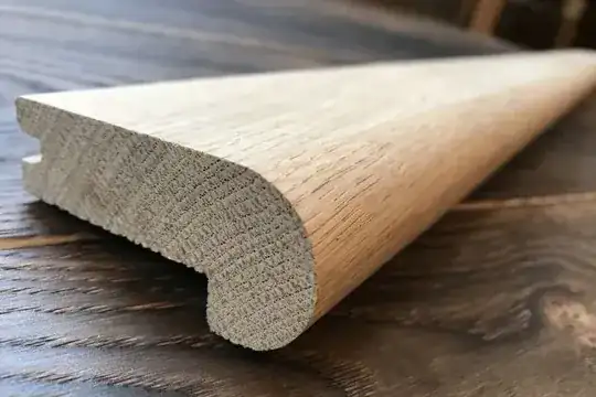

Transitions like this are needed in flooring often. Choose some materials to build a bullnose to cover the concrete. To match the color and style of the lower floor you might pick unfinished or pre-finished wood like oak, maple, or alder. To match the color and style of the upper floor you might pick a strip of real or cultured stone like marble. IMHO it looks nicest when the nosing matches the upper surface so I'd choose the stone.
If you have a few spare matching tiles in storage or can get more it might help things if you cover part of this space in tile. It looks like you have about 7 inches of floor to cover, whereas nosings are often offered in narrower widths like 4 inches.
Whichever material you choose it's probably easiest to fasten with construction adhesive applied directly to the well-cleaned and dry concrete.
Photo credit: www.peakoak.co.uk and www.tileshop.com. oak bullnose marble bullnose

  • I considered getting rid of the door all together but this goes from the kitchen to a laundry area and then to the 4th bedroom so wanted to be able to separate the 3 different rooms as much as possible. I think I do have some extra tile but I think it would look odd as the tile that ends under the threshold is only 3/4 of a full square. So, if I went that route I'd feel like I would have to bust up the 3 tile and lay new. Matching grout would be tricky as well. This is a renthouse that's been off the market for a year due to Hurricane Laura damage and I'm trying to get it back on mkt asap. – LiquorGuy Aug 20 '21 at 16:34
  • I think I'm going to go the route of laying down some wood that matches the LVP that I have down already. – LiquorGuy Aug 20 '21 at 16:35
  • A pre-fab bullnose threshold or stair tread, eh? Why didn't I think of that? – FreeMan Aug 20 '21 at 18:02
  • @FreeMan Due to the width required it may yet be necessary to fabricate a custom bullnose! – Greg Hill Aug 20 '21 at 18:32
