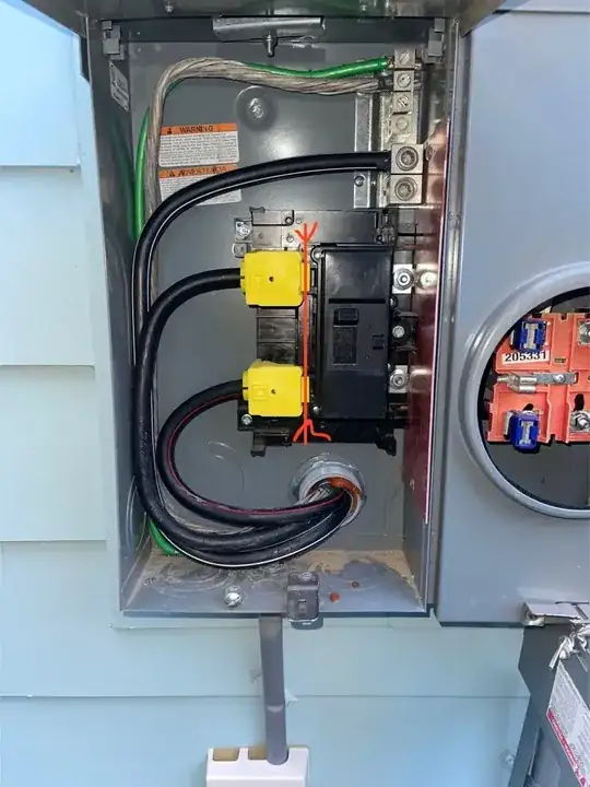

Our neighborhood and my house has Square D QO equipment. There is the external main shut off with a 200 amp breaker. It goes straight to lugs and then the wires that go to the main panel in the house with all the house circuit breakers. I took a photo of how it looks outside on the house next-door who is awaiting hook up and closing. I drew a red line where I would want to insert one two pole breaker to put a surge protector on ( I have a Seimens First Surge Pro.)
What would have to be replaced? I see that 200 amp breaker being sold where it has the attachments for the meter on one side and the lugs on the other. Is there some thing that could attach those lugs that would give me a mount for a circuit breaker and then has lugs on the other end to reattach the wires going into the house? Or does that whole black plastic assembly that the main breaker is mounted on have to be replaced? How would you do it. Thank you so muchenter image description here

  • @hometech99 -- can you post photos of the labeling on the inside of your meter-main's door please? – ThreePhaseEel Aug 24 '21 at 01:17

TL;DR Put it in the main subpanel (i.e., in your house)
There are "Meter Mains" that include:

Yours is not like that. It has the meter and the main breaker and a feed to your main panel. And that's it. The ones that include some regular breakers use them to (a) feed one or more subpanels (either in one or multiple buildings), (b) provide an outdoor convenience receptacle, (c) help with generator and/or solar hookup (those can get tricky) and yes, (d) can handle a whole house surge protector. Note that technically this is the main panel (whether it has additional breakers or not) in terms of neutral/ground bonding.
But this panel simply isn't designed that way. While a surge protector would function in this location, I really wouldn't recommend it. There are some real safety issues, and the bottom line is that the box simply isn't built to take anything extra.
Just put the surge protector in the main subpanel (i.e., wherever these big wires end). The good news is that since you have an outside disconnect (the main breaker here) you can work on the inside panel in complete safety. Depending on the surge protector and the panel, it may be designed to go in the top breaker spaces (assuming feed comes in the top) of the panel, or possibly even connect to the main lugs - follow the directions carefully.

The entire gray thing needs to be changed.
Right now you have a "Meter-Main" which has only a meter and main breaker. It has no space for any other circuit breaker.
What you need is a Ranch Panel, which has all of these:

Or, you can put a 200A panel with Thru-Lugs here.
To avoid having to replace the meter box, you could obtain a standalone main-lug panel which has thru lugs. Come off the main breaker over to this main-lug panel. Then go from its thru-lugs, via the meter-main, to your master panel indoors.
Normally you could just "tee" off the 200A main feeder wires, but your goal here is surge suppression.
Or, you could relax about surge suppressor location.
Because I'm only advising this stuff because you want it. I would never go to all the trouble, I would just the surge suppressor(s) into the master panel (the one with all your breakers) and be done with it.
