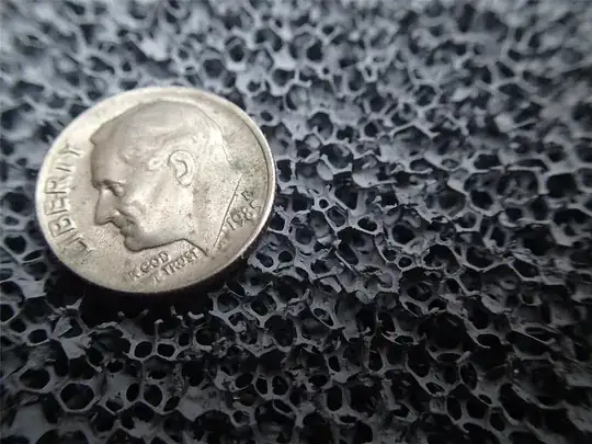

We have half-round gutters so the choices are more limited than they are for K-style gutters. The diamond mesh clip-on gutter guards that we have now do not work very well. The diamond-shaped holes are about 8mm x 6mm and small seed pods fall through the mesh easily and clog the gutters; leaves also get snagged in it. Someone still must climb the ladder to clean the gutters and the guards only make that effort more difficult.
I recently bought a small quantity of GutterStuff to try it out. Just installed it yesterday in fact. Installing it in 5" half-round was easy. You just press it down into the gutter. It is a springy compressible material.
I'm attaching a close-up picture of it. Nothing should be able to fall through the material into the gutter, although seed pods and small leaves might get snagged on the surface. Time will tell. I'll update this posting in the fall.
A smooth, very fine mesh would work best since seedpods and leaves cannot get snagged in it or pass through it. But I haven't found a product like that for half-round.
P.S. From a DIY angle, a 5" roll of stainless micro-mesh coupled with GutterStuff might solve the problem nicely, if the micro mesh could be bonded or fastened to the surface of the GutterStuff. Two beads of latex sealant might be all that's needed. Easy installation with the benefits of mesh -- not having pine needles and such getting embedded.
