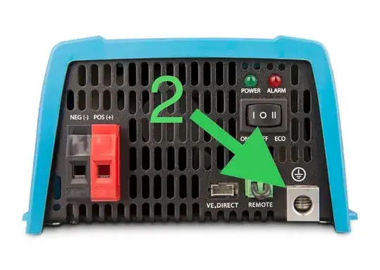

2: Regarding the ground on the inverter (seen in the next image), should I be connecting that to the chassis of the RV?

However, with the house's bond broken, the only neutral-ground path is onboard your RV. So all the range's fault current goes out ground on your 30A extension cord, to your chassis, through that FJ2 connection on the Victron, back to the panel and out the RV's neutral wire. And because of the very long wire run, only 80A flows. That could take 30 minutes to trip a 50A range breaker*. Remember all this current is moving on neutral and ground, which don't have fuses.

Grounding the neutral creates a parallel path for return , or in some cases with the neutral connected to the PE it is possible for some one standing on the earth or touching a metal fence and the trailer to get a shock because of the parallel path. I am not sure of the wiring but your inverter may only connect the ground to neutral when on battery or actually producing a separately derived voltage (code speak).
