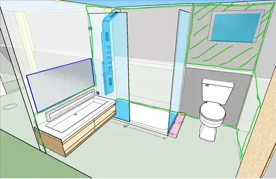

I have this layout and all the areas marked with green will get tiles I am not sure about the area around the window (marled with diagonal green lines)
The area I have doubts about is the area above the green line at the bottom of the mirror. I have cement boards that would cover that entire wall (2 sheets less than 8' long)
From what I am reading the cement board could be painted over, or more accurate said, certain types of cement board
What would you recommend me to do in this case ? Should I transition to drywall in that area behind the mirror ?enter image description here

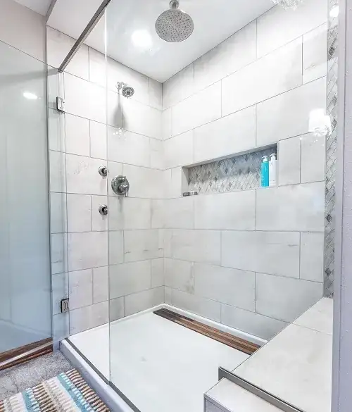

You do not need to protect the entire bathroom with cement board, no.
However, the cement board and tile should extend past the tub/shower at least a little bit so that drywall isn't the first victim of excess water splashing out.
Per:
Notice how the tile goes past the glass door.
If you did cement board the entire bathroom then you could apply drywall on top of it and end up fairly flush with the tilework. You will of course have to use cement board screws to attach the drywall so things could get expensive. You'll still want to extend the tilework beyond the tub-shower for the aforementioned reasons.

  • Hmm I like the idea of getting flush with the tiles by adding drywall on top of cement board. The question is ...will it be flush? In particular for my project that wall requires some attention as due to error when I did the plumbing for the shower drain my shower base is now 1/2" off the framing on that wall so I need to shim like 1/4" in order to have the cement board sitting on top of the flange. – MiniMe Aug 30 '21 at 16:51
  • @MiniMe If your goal is for the wall to be flush with the tile then it would be much cheaper to double up the drywall instead of cement boarding everywhere; cement board is 2x the cost of drywall and the screws are expensive. Cement board will corrode regular screws into failure. I believe thinset is usually 1/8" thick so add the thickness of your desired tile to get your drywall calculation. Doubling up half-inch drywall might be right or you might need 1/2" + 3/4" to make it flush. – MonkeyZeus Aug 30 '21 at 16:58
  • I already bought the cement boards, maybe too many of them, it will be a PIA to return them ..and I also bought a box of these https://www.homedepot.ca/product/cgc-durock-screws-for-durock-cement-board-1-1-4-in-200-screws/1001341803 It seems that I need to go back to the drawing board to plan my cuts and my transitions and the layers that you suggested as well to see if it would work that way. It might save me the shimming if I put cement board in the mirror area. I will have to use it anyway below that as I would like to tile ...let me do the maths to see how I am doing with tiles as well – MiniMe Aug 30 '21 at 17:12
  • @MiniMe That's your call. The other consideration is that those 1 1/4" screws won't be long enough to penetrate at minimum 3/4" into the stud. You need at least 1 5/8" screws to secure the second layer on top of the first. – MonkeyZeus Aug 30 '21 at 17:18
  • @MiniMe Also, using cement board everywhere will make electrical work that much more of a pain. An oscillating tool will help but you might eat through a few blades by the time you're done. – MonkeyZeus Aug 30 '21 at 17:20
  • I have no electrical outlets on that wall. I guess 1 1/4" won't do it if I add drywall over cement board. I am seeing one more problem with this layout...the two materials have different behavior when taking water ... I have to decide if it is worth tiling behind the mirror and above it, in each case I can use the cement board on that entire wall as planned. I will use cement board around the toilet so I might not waste cement board if I cut is short after I covered the shower – MiniMe Aug 30 '21 at 17:25
  • @MiniMe These sound like questions only you can answer =) – MonkeyZeus Aug 30 '21 at 17:30
