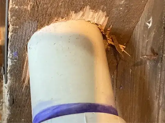

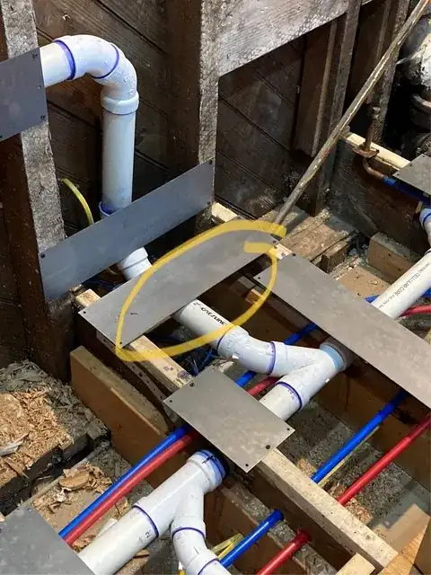

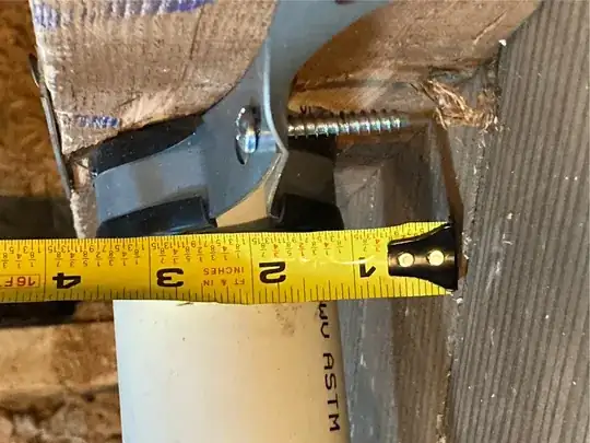

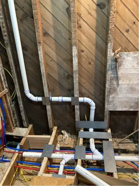

I'm doing a bathroom remodel and adding a utility sink for my wife's art studio on the floor above. When we talked over the plan, I decided to go with the 2" drain they said I should use, but I had wanted to send it through an interior wall. However, they talked me into the exterior wall and said they would connect to the tub drain right where it came down. I even installed a ledger ahead of time and we talked about drilling through it for the drain.
Somewhere along the line though, the plumber changed his mind and went through 2 structural 2x4s. I was shocked when I saw it. There's less than an inch of wood on either side of the hole.
What should I do? Doesn't this weaken the wall? It even blocks me from installing the other ledger I'd planned and one of the joists it goes between has a huge gouge out of it I'd planned to deal with.
Here are some pictures:

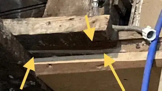

Gouged joist I planned to work on

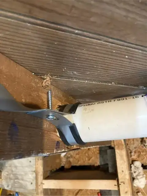

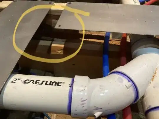

Metal is resting on the drain

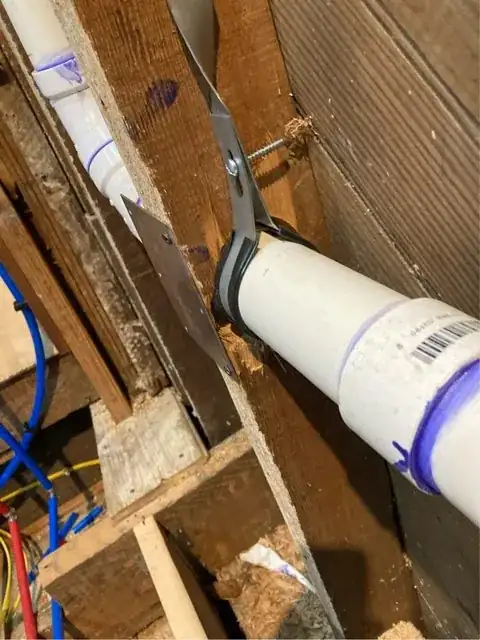

less than an inch of wood on the sides
I thought I would add an earlier picture of the joist I was going to shore up. It's a little hard to see due to the shadow, but there's a horizontal chunk of wood that is missing just above the sister. My plan, before the pipe was unexpectedly routed there, was to add a ledger on either side. That joist was notched way too wide before I bought the house. Now with the pipe in the way, I'm not sure how to address this.

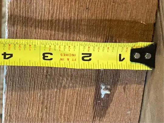

More pics - Adding a few more pieces for better visualization of the off-center stud hole:
lower shot of off-center hole
with tape measure
stud depth
stud width
hole through other stud is smaller and centered better
Update: I just spoke with the building guy at the township construction and code enforcement office. He pointed out that given the shape of my roof, it is a loadbearing wall. I forget the name of the roof type, but it's essentially almost like a pyramid (with a wide peak). I thought this was a significant detail I should add.
no wood in front

    The minor annoyance is that he wasn't drilling guide holes before screwing through my shims I used to level the floor, but that's not a big deal. My main concern is structural integrity. How much of a concern is that? I mean, a hole through 2 exterior 2x4s that leaves less than an inch of wood on either side seems pretty alarming to me. When I was learning about doing this DIY, my understanding was to not do this because they're structural. – hepcat72 Sep 04 '21 at 01:57
  • Have him take it out, do it right, then sister the two studs. It’s only permissible to compromise the structural integrity like that if no alternative route is an option. – Kris Sep 05 '21 at 14:08

Old houses, like yours, that predate modern lumber dimensioning often can't use stud shoes, as you discovered. Since you're in that boat, you can try nailing a 8-10" piece of 2x blocking that's been notched to go around the pipe to the studs in question (this was what was done to reinforce the studs that were notched for the kitchen sink drainline in the 1950s ranch I live in).
For folks with modern studs...
This sort of problem is precisely why stud shoes are a thing. These are sheet-metal pieces that fit over the pipe-in-stud-hole and are nailed or screwed into the stud to reinforce the weak spot the hole created. I'd use Simpson HSS2-SDS1.5s (shown below) for this job; they're a bit trickier to install as you have to bend part of them around behind the pipe, but they're capable of transmitting both tension and compression around the hole, something regular stud shoes aren't rated for. (They also come with all the screws you need to install them.)
Simpson Strong-Tie HSS2-SDS1.5 stud shoe
P.S. If the shoe doesn't quite fit because the hole's too far forward, you should be able to use a shim between the front of the stud and the front of the shoe. The results won't be great, but they'll be better than what you have...

  • What about the ledger I had planned to install? We're getting a cast iron claw foot tub and I'd planned to reinforce the floor there where the foot would go (and where the joist to the right had a big chunk of wood that came off. Plus, the metal piece they installed over that spot rests on the pipe right around where the foot will go. – hepcat72 Sep 04 '21 at 10:38
    @hepcat72 If you look up the product pdf for the Simpson Strong-Tie stud shoes, the flange (part that appears to be in the way of installing over pipe) actually can be bent down 90 degrees to get it past the pipe, then you bend it back up. – anjama Sep 04 '21 at 14:35

  • It looks to me that this studshoe can be installed after the pipe is in place by bending out "wings". But if this studshoe is installed before the holes are bored, then it only permits a hole of a certain size to be bored, and directs the location. It looks like these holes are larger than normally allowed and maybe larger than this studshoe will accept. – Jim Stewart Sep 04 '21 at 20:39
    @JimStewart -- they are larger than what's normally allowed, but the OP described the pipe as 2" PVC, which is the largest pipe (OD = 2.375") that the Simpson shoes accept – ThreePhaseEel Sep 04 '21 at 20:41
    Are plumbers qualified to install stud shoes? I always heard that when the plumbers and HVAC techs cut framing they shouldn't it's the framers who have to restore the framing to acceptable structural integrity. – Jim Stewart Sep 04 '21 at 20:58
    A possible problem is that the hole is off center so the stud shoe *might* not be able to fit tight to the face of the stud without contacting the pipe. – Jim Stewart Sep 04 '21 at 21:12
  • @JimStewart Yes, I thought of that and am concerned. Also, these are studs from 1920, so I'm also concerned that the dimensions may be off for the shoe. The plumber boss is coming sometime this week to discuss the problem and do the drawings for the permit/inspection. – hepcat72 Sep 05 '21 at 14:14
  • @ThreePhaseEel - Could you add to your answer to address the possibility that the shoe may not fit given the hole is off-center? Do you think in that case that the hole should be widened, the shoe somehow adjusted, or if it doesn't fit, should the pipe be rerouted and the studs sistered? What do you think? – hepcat72 Sep 06 '21 at 14:13
  • @hepcat72 -- is the hole closer to the front edge or the back edge of the stud? – ThreePhaseEel Sep 06 '21 at 14:15
  • Front, unfortunately. You can tell from the fourth picture in the question. I'm concerned that the shoe will protrude away from the face of the stud and I wouldn't know how to deal with that. – hepcat72 Sep 06 '21 at 14:17
  • I just added 5 more photos for better hole placement assessment at the bottom. – hepcat72 Sep 06 '21 at 14:32
  • So when I took that next batch of pictures that I added, I noted how much bigger the hole is then the pipe. I just had the thought that maybe the pipe could be moved to be in a better position to fit the shoe, however I know what they will say if I suggest that. They will say that the pitch of the pipe would not be to code. He said that several times with the placement of other pipes, so I know he was trying to get the angles right so that it would pass inspection. – hepcat72 Sep 06 '21 at 14:37
  • A stud shoe isn't going to fit those studs without some chiseling. I really don't think it's necessary anyway. – isherwood Sep 07 '21 at 12:51
  • @ThreePhaseEel Well, the stud shoes arrived and I just held them up to the stud. They won't fit. My studs are 2&1/8" thick and these shoes only accommodate 1&1/2" studs. :( – hepcat72 Sep 12 '21 at 18:14

There's really nothing to worry about here.
  1. Yeah, the holes should've really been centered. A stud with even 3/4" of wood on each side retains much of its original stiffness, and the strength lost for just two studs is not significant. A stud with what's effectively a large notch loses a lot of stiffness. However, it's not a concern for just two studs in a wall system like this.
  2. You don't need to repair this with hardware. There's a huge amount of strength in that wall system. Solid wood sheathing spans all those studs and ties them together. Nothing is going to fall apart. It's been done just like this for a century.
  • I just added another picture to the bottom of my question. It shows that there is essentially no wood to one side of the pipe. So it's not 3/4 of an inch. It's more like an eighth or less. Does that change your answer? – hepcat72 Sep 06 '21 at 15:07
  • Also, from a contractual standpoint, if the plumber changes the design that I approved, they should review changes with me before implementing them. I am essentially the builder responsible for making a call on something like this. Had I been consulted, I would definitely have opted for an alternate solution that did not go through the studs. The reasoning for making the drain connection 2 joists over is likely a valid one, however in that case I would have suggested bringing the pipe down in that section between those two joists instead of cutting through the studs. – hepcat72 Sep 06 '21 at 15:51
  • Not really. It's two studs (one, if you just consider the off-center one). – isherwood Sep 07 '21 at 12:44
