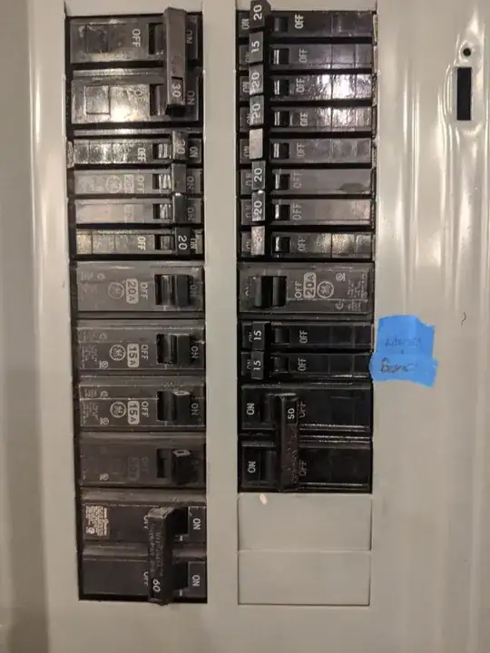

I have before and after pictures of the panel. The water heater was on the 3rd breaker down on the left, the 20A one which is my "2 pole 2-slot" breaker as opposed to the other 2-poles which seem to often take up 4 slots.
Before
After:
Aha, looks like the breaker was moved up for the GFI. (I opened the panel cover and have confirmed this is indeed the breaker for the water heater) And if I'm reading the wiring diagram correctly...
It appears that it's now on pins 9/11 which is one phase, instead of staggering 11/13 which are 2 different phases.
I'm wondering
  1. Was the original configuration legitimate, or is that fundamentally wrong?
  2. This was done by a licensed electrician. Is this some common mistake or should I be wary of having them come back to fix this?

    You're not showing us enough of the panel in "new" configuration. Clearly a 20 and a 15 "went away" to accommodate the new setup. *Where did they go?* I fear to ask! – Harper - Reinstate Monica Sep 05 '21 at 00:49
    Fair callout @Harper-ReinstateMonica I've uploaded an image clearly showing the full current panel. – brenzo Sep 05 '21 at 01:22
  • What was the old 50 amp breaker? Where did it go? By the way waas there any conversation about hardwiring the EVSE? – Harper - Reinstate Monica Sep 05 '21 at 01:27
    The old 50A, to my knowledge, was unused. Unfortunately I am a renter at this unit, and had permission to install a 220V NEMA 14-50 from the owner, if I covered installation costs. I have only lived here a month and did not inspect inside the panel before the work was done, but I can confirm it was off initially. No conversation about it, but as a renter I was inclined to opt toward a cheaper and non-Tesla specific solution. – brenzo Sep 05 '21 at 01:33
    @Harper-ReinstateMonica for context, the 50A was actually the original install location of the charger (thus double confirming it was unused). Without a GFI. This, of course, failed inspection and the electrician came back to "fix" the work which leaves me with the mess you see now. – brenzo Sep 05 '21 at 01:37
13
Oh boy...whoever did that work really botched it up good
You need to call whoever rearranged those breakers back and tell them to fix their messed-up work on their dime, or better yet, pay someone competent of your choice to fix their errors. What they did took a perfectly fine panel configuration with spare slots in it and likely damaged it, atop rendering your water heater and another 240V branch circuit inoperable from having both legs of the circuit put on the same supply leg. (If that other 20A 2-pole breaker was on a multi-wire branch circuit, it's worse, because now you're putting 40A down the neutral when the circuit's fully loaded.)
The reason for the issues with the panel is that GE "double-stuff" two-pole breakers are designed to straddle adjacent panel spaces, the way you see done in your original panel, and the panels are keyed to keep a two-pole half-width/double-stuff breaker from being stuffed into a single space the way whoever needlessly rearranged things did. So, they mangled the keying features on either the breaker, the buswork, or both in order to misplace that breaker.

  • Thanks for the explanation, what a mess. So are there any double poles designed to fit that space, or do they always straddle adjacent panels? NB I have called them and informed them of the various issues and let them know I would like to have someone else repair the work at their expense. – brenzo Sep 05 '21 at 00:15
  • @brenzo -- they always straddle adjacent spaces – ThreePhaseEel Sep 05 '21 at 00:49

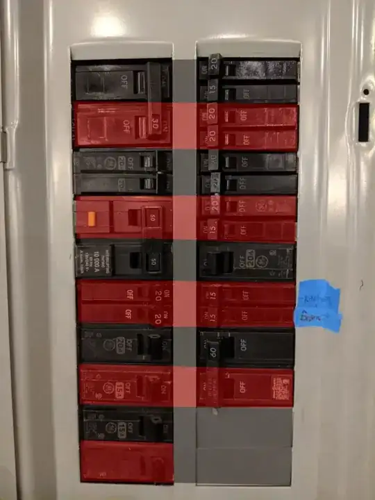

Apropos to that link, let's look at the phase striping on YOUR panel: Before.
Notice how the 30A breaker at the top left touches both poles by sitting in 2 spaces. Note the size of this breaker and how it's the same size as the "4" half-width breakers below it. The center two are the breakers of interest for the water heater.
Boy, if you followed the above link, those really look like a quadplex, don't they? That's how GE's breaker system works. It's a "build your own quadplex". The top is a 1/2" wide (half width) 120V breaker. The next "2" breakers are a 20A/240V breaker, 1" tall. The bottom of the stack is another 1/2" width 120V breaker.
Notice how the 240V breaker must straddle 2 spaces, with a half-width breaker above and below it, essentially there as filler.
Now, let's see what the goobers did. After:
First, why the heck didn't they put the breaker at the lower right? eyeroll Clearances maybe?
Anyway, you can see where our "GE DIY quadplex" has been broken up. The outer singles have been pushed below the 50A breaker. The center 240V breaker has been placed above it, in an even space. It is no longer straddling spaces and no longer has access to 240V.
They should not have separated that "DIY quadplex". If they had simply moved the GFCI up or down 1 space from where it is, they'd have had a 2-space block to easily put the "DIY quadplex" phased just the way it was.
As ThreePhaseEel points out, the 240V THQP breakers have a "reject feature" to not fit in the wrong places. But it's only plastic, they probably force-fit it and broke it. Fortunately, that breaker is under $15.
Nothing goes in this panel except for GE THQL (wide) and THQP (narrow) breakers... and Eaton's CL line (wide) which is made for this panel.
To add onto what Three-Phase and Harper said, here's why they probably missed it
It's hard to see, but there's a piece of metal stuck between the breakers. I used Harper's colored version so it's easier to spot the phases. The metal runs between the handles so both phases trip if one goes. You have not one, but two 20A 240v setups using half-size breakers.
240v setups on half-size breakers are pretty uncommon but not disallowed. Your installer was probably only used to the normal two-slot 240v, which are much more common. That's no excuse for this, however. There should have been ample warnings this was a 240v setup.
If I were you, what I would do is not demand they put it back the way it was, but instead you need to play musical breakers. On the left side, you have four full-size 120v breakers. What I would want done is that they put your water heater on a normal two-slot 240v breaker, and then swap out two full-size for half-size breakers down the line. This might mean a lot of pigtailing (this screams "Let's make the wires fit on the current breakers"), but the end result should leave no doubt where the 240v water heater breaker is.
And, of course, find out why the bottom two slots on the right went unused. Again, my bet is short wires. If possible, swap that other 240v setup out for an obvious two-slot breaker.
