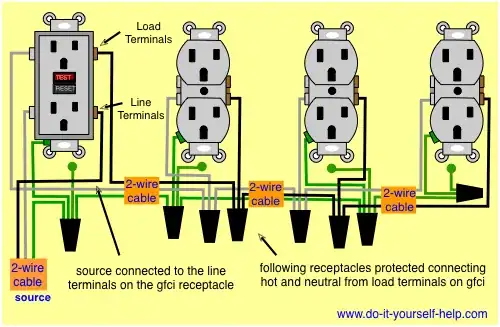

I've got a house where lots of duplex sockets are wired through a single Ground-Fault Circuit Interrupter (GFCI)
I'm pretty sure this is the appropriate diagram.
Ground Fault Circuit Interrupter System
There is a GFCI socket on the inside wall of the garage. Based on occasional outages, I'm pretty sure that single GFCI "controller" drives simple duplex outlets on the outside of the house, plus in the garage next to the water softener, and finally in the laundry room behind the washer and gas dryer.
