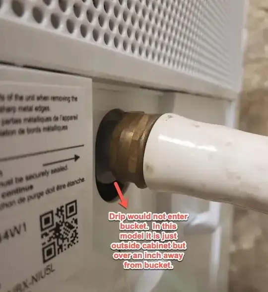

This sounds like a leak at the internal connection from the bucket drip point to the hose adapter.
Internally, our Artic King dehumidifier has a small pipe coming out of the dehumidifier over the bucket. It also has an attachment to convert the unit from bucket to hose. The attachment consists of a plastic flange for the hose to attach to and a short piece of flexible plastic hose that press-fits over the bucket drip pipe. The plastic hose is only press-fit and I see how it could stiffen over time, no longer press firmly over the bucket pipe, and start leaking into the bucket.
Triplefault
  • 6,374
    Yup, that's what it is. Hose leak right at the coupler, or faulty gasket in the coupler, or in my case a limp wrist doing the tightening. – Harper - Reinstate Monica Sep 05 '21 at 21:33
  • The problem with my current unit and at least one previous one is not a loose hose or gasket. I can't be sure about every one of the units that did this, but in my current and previous one the hose outlet is outside the cabinet. A loose or faulty fitting would cause water to drip on the floor, not in the bucket. Will add photo to question. – jay613 Sep 06 '21 at 11:31
  • To further clarify, one of my previous units had a "hose adapter" that INTERNALLY screwed into the machine but my current and all other ones had a hose "outlet", fully and permanently integrated into the inner drip tray and sticking outside the machine where the hose attaches. – jay613 Sep 06 '21 at 11:58
  • The design in your pictures is different from my unit, so it appears that a loose internal hose may not be the problem, at least on the present unit. – Triplefault Sep 06 '21 at 14:12

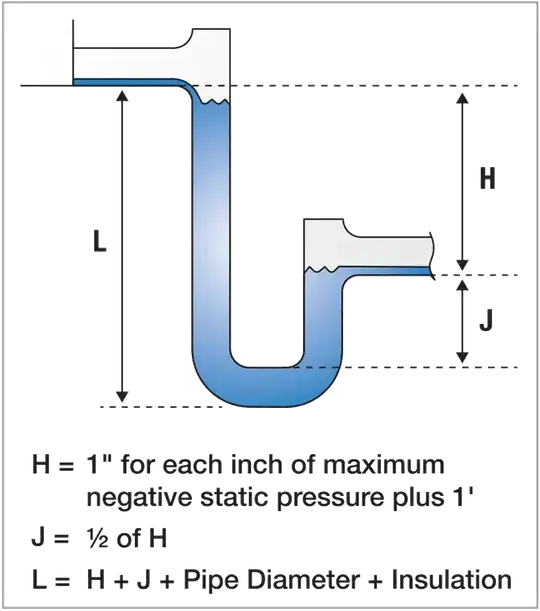

I want to give Glen Yates the credit for cracking this (at least for my situation, which may or may not be the same as the OPs) but his comment on the question about p-trap put this together for me. My basement is pretty damp without dehumidification. Better drainage has helped but if I don't run a dehumidifier 3-seasons of the year, my tools rust, and anything that absorbs humidity like paper or cardboard will be damp to the touch. I've dealt with a number of issues like the tilt of the dehumidifier, pinched hose, clogged hose, etc. and it works reliably now, with one particular exception: when we get heavy rains, I have learned that I need to go down and check the bucket. It will often be filled and the dehumidifier stopped.
This didn't make sense to me. How could it be that the dehumidifier was pulling more water out of the air than a garden hose can handle? But then Glen mentioned a p-trap. And I looked into it and it all makes sense. The p-trap on a AC unit is there to prevent air from coming into the unit through the condensate drain as described here:
Since the Air Conditioner is at a negative pressure relative to the outside air, the outside air will rush into the air conditioner through any openings (the condensation drain, is an opening). On our A/C the air rushing in through the condensation drain was preventing the water from exiting through the drain.
Now it makes sense why I'm seeing that. A dehumidifier is very similar to an AC unit. If it's pulling air through the drain line, water can't exit through it and it ends up in the bucket. In normal circumstances, the unit will cycle frequently enough that the water doesn't reach the level required to go into the bucket (per your drawing.) But if it's running continuously for a long time, there's no pause in the negative pressure and it will drain to the bucket and then stop running once it's full.
So I'm going to be hooking up a p-trap on the drain connection of my unit. Maybe this will help you as well. I found this page which has a lot of technical details around p-traps and includes this helpful image:
Initially I wrote that I thought the image is inaccurate because water will find it's level. But if it's under negative pressure, perhaps the image shows the amount of water column height needed to keep it from being pulled into the pan. I just had this happen again and it was after a heavy rainfall that lasted for multiple days.
