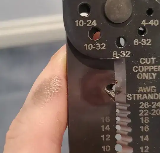

I just had a near-disaster while trying to install new smoke detectors. My house has AC hardwire connections for the smoke detectors. I wasn't sure which circuit the smoke detector AC connection was on, but after going through the breakers one at a time I found that they were on the same breaker as the dryer for some reason.
I verified that the circuit was off using two methods:
  • While the circuit was on, the smoke detectors all showed a green LED indicating AC power. After shutting off the breaker, the green LED went off on all smoke detectors.
  • While the circuit was on, my non-contact voltage detector went off when I held it near the hot wire connected to one of the smoke detectors. After the circuit was off, the voltage detector gets no reading from the hot wire.
I started with the smoke detector I'd used the voltage detector on. I unplugged the old smoke detector and checked to make sure the new smoke detector fit. I discovered that the new detector wouldn't fit because it has a bulge that would need to stick up into the junction box, but there was no way to make it fit because the wires in the box were so long (roughly 8 inches from the ceiling + wire nuts and another 2 inches to the AC connector) that they filled up the whole box. I decided to trim the wires back a few inches.
I grabbed my wire tool and cut the red interconnect wire first. Then I did something which in retrospect was very stupid: I cut the hot and neutral wires at the same time, thinking I was safe because the circuit was definitely off.
As soon as the cutter made it through the rubber insulation, it bridged the connection between hot and neutral and EXPLODED. A huge shower of sparks burst from the wires and I fell off the ladder screaming. By some miracle, I escaped unharmed and the sparks didn't set anything on fire.
I'm guessing the only reason I'm not in the hospital or dead right now is because I was on a fiberglass ladder and the wire tool has an insulated rubber handle. You can see here where the arc burned through the metal and lightly singed my finger.
The arc burned a hole in the metal and singed my finger.
After I recovered, I checked the hot wire with the voltage detector (still no reading), checked the other smoke detectors to make sure they weren't getting power (still no green light), and finally went outside to check the breaker (still off).
What went wrong here?

58
After writing out the question, I realized I had forgotten to check something. I went back to the panel to see if any other breakers besides the dryer circuit had flipped off, and sure enough, the "garage light" breaker had been tripped. After testing more, I determined that the smoke detectors are actually on the "garage light" circuit breaker, not the "dryer" circuit breaker.
So apparently in all of my going back and forth to the panel and testing different breakers, I somehow confused myself on which circuit the smoke detectors were on. False positives from my NCVD may have initially prevented me from realizing when I did have the correct breaker shut off, and definitely caused me further confusion after the initial accident.
