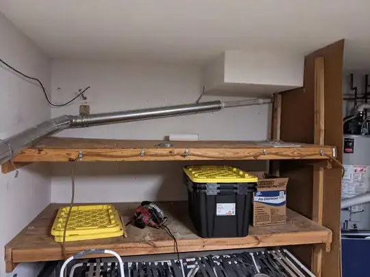

A contractor just finished installation of new HVAC system with a category 1 furnace (model: GMES800805CNAA).
He originally used a reducer to connect 4 inch exhaust to a 2 inch PVC pipe. He claimed that he has done so in the past and it worked well. After we started the new unit, we ran into some issues and eventually ended up with a completely melted PVC pipe. He replaced first few ft of the exhaust with a metal 4 inch pipe, but terminated it with a PVC 4 inch to 2 inch reducer and let it vent through the wall.
His claims that PVC melted because it is summer, and during winter pipes will be completely fine.
Is it safe to use a PVC 4 to 2 inch reducer and PVC pipe venting to the side of my house?
replacing melted pvc: enter image description here
finished product: enter image description here

Whichever joker is installing an 80% furnace with a PVC pipe for the exhaust needs their license revoked pronto, because that's a patent CO hazard. Non-condensing appliances operate at flue temperatures well above the safe working temperatures of PVC or any other plastic, and thus need to be vented using a metal B-vent. (Conversely, condensing appliances generate corrosive condensate that will eat ordinary B-vent alive. Stainless steel double-wall can be used as a "universal vent", and is what you're supposed to use on condensing appliances as per UL listings, but the condensing gas appliance manufacturers haven't quite gotten the memo incorporated into their install manuals yet.)

    pvc-NO..1. A reducer is a no-no. Creates back pressure and is not allowed 2. You cannot run the exhaust horizontal it must slope upwards.( quarter-inch per foot) 3.Safety Controls i) A fan proving switch that prevents the heater from operating if the power vent used to operate the side wall vent is not working ii) A timer control that keeps the power vent operating for a period after the burner has stopped, typically for 45 seconds, to purge remaining combustion gases from the heating appliance NB Safety controls and power vents for gas fired heating appliances are certified by the AGA, – Brad Sep 09 '21 at 11:02

    Update: Not sure if one of the agencies that I reported him to reached out to him, or if one of his 'colleagues' was an actual certified HVAC technician, but contractor completely changed his tune and went from "I already did all the work. Contract is done. I cannot return unit. If you want new one you have to pay me for new unit and full re-installation costs" to "Just pay me the difference for high efficiency furnace and one that you have, I will replace it for free.". Thanks everyone for giving me courage and information I needed. Y'all might have just saved my life. Will post updates. – Dimi Sep 09 '21 at 19:54

    @JacobKrall I have hired a local HVAC professional to advise me on this matter. He said that the best course of action for my wallet is to have that 'contractor' replace 80% unit with 96% one (I will only pay the difference in cost of those units) and have an HVAC/Code professional thoroughly examine his work to make sure everything is good. Furnace is being replaced right now. Gas valve will remain in OFF position until all work is inspected by a 3rd party. – Dimi Sep 10 '21 at 17:05
