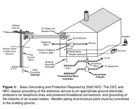

What NEC/CEC, IEEE and ARRL say...
Most buildings now have many additional outside connections—exterior lighting, remote gate controls and security monitors, electronic dog fences, auxiliary buildings, etc., which are often not dealt with in the codes. Any of these connections can bring damaging lightning currents into the building.
Finally, and most significant for many people, modern houses have from $5,000 to, in rare cases, $500,000 of electrical/electronic equipment, such as in utility systems, home entertainment systems, computers, security systems, and building automation systems. All of these are extremely vulnerable to lightning surges brought in on power or signal cables, and the basic NEC/CEC requirements do little to protect them.
Ref: How to Protect Your House and Its Contents from Lightning, IEEE Guide for Surge Protection of Equipment Connected to AC Power and Communication Circuits, Published by Standards Information Network, IEEE Press

In the event of a lightning strike you'd want a fault/short/path to be created from whatever metal is struck to a grounding wire bonded to house earth. If it doesn't save the electronics, grounding still stands a chance at saving the house. The point is to guide as much energy to ground as possible before it reaches electronics inside.
Amateur Radio operators know this best, and they earth the coax shield of their antenna wires before entry and also bond it to the house ground. Binding prevents voltage differentials between external ground and house ground, that result from nearby strikes that cause a so called "ground lift". Of course, their needs are much tougher due to the use of tall or or high placed antennas, but the principle is the same for other outdoor electronics wired into the house.
