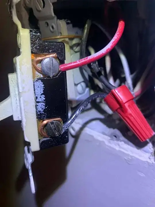

UPDATE: Thank you for all your help. I ended up taking all of your advice and fixed the switch! I found that the previous person who owned this house, or the previous electrician just did some questionable things after learning from you all! Here's the final image: enter image description here

  • @LShaver TBH, now that I look at the new pic the OP posted, I'd guess that the black wire was bent around needle nose pliers with that nice, smooth curve, and the red wire was bent with _something else_ because of the sharpish kink. IMHO, the black wire is a better hook, but I'm not a pro, so it's just my opinion. – FreeMan Sep 23 '21 at 14:17
