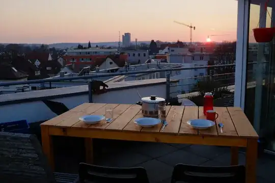

You don't need powertools, especially if your livelihood doesn't include woodworking.
Woodworking is a kind of meditation for me, and I could not relax while using powertools. Sure, it's slower with hand tools, but being fast really is not the goal. And this way, I know I cannot lose a finger during a second of inattention.
It's possible to create awesome objects with just a few tool:
The only power tool I ever use is an electric drill. I sometimes use a brace, which works perfectly fine.
The stuff I produce has many small flaws, but I don't care much. It's still a great feeling to see my daughter play with her Lego castles on a shelf I created, or eat dinner in front of a sunset, on a DIY table.
There are thousands of techniques to learn with hand-tools, and there are many low-tech tutorials on the Internet (just one example: "how to saw with a Japanese pull saw").
If you watch woodworking tutorials with powertools, you can very often find alternative ways to follow them with hand tools. I followed this tutorial for the DIY table, simply using a Ryoba instead of a Miter saw.
Finally, woodworking is much more than simply cutting wood : planning, measuring and getting the right pieces of wood are all extremely important steps too, and you don't need powertools for those. Measure twice and cut once.
Eric Duminil
  • 477
    You see "flaws", the world sees a hand crafted item with character and love. See the positive. – Criggie Sep 23 '21 at 08:28
    @Criggie Thanks. And yes, definitely. I just wanted to mention an objective advantage of power tools : they can give you very clean and straight results relatively easily. – Eric Duminil Sep 23 '21 at 08:43
    This. (And a comment up above). You can do a *lot* of work with hand tools very well for comparatively little effort, if you practice. And it's really worth learning, because it will make you much more like a crafstman when you *do* use power tools, and much less like a cowboy. Personally I'd advise a newbie to avoid sandpaper for a bit and learn to use a plane + paring chisel + spokeshave, because you *feel* the wood rather than 'imposing' a shape on it by abrasion. Really nice furniture btw. – 2e0byo Sep 23 '21 at 09:56
