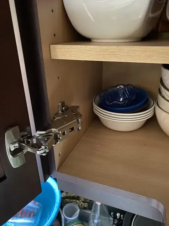

My parents have some cabinets in their kitchen and the door suddenly stopped closing. It seems the bottom hinge is the issue. I tried adjusting it followingthis PDF but it still just won’t close. I’ve added some photos of the door and hinge

    Somewhere near the middle of the plate that attaches it to the cabinet, there's a screw on the main part of the hinge. Loosen it; pull the whole door forward and re-tighten that screw. Probably do that up top. Report back. – Aloysius Defenestrate Sep 19 '21 at 20:59
  • If you do ask this on DIY could you please link to the Q here in a Comment? I'll be interested to see if more than one Answer, or a consensus view, is to get a new hinge. jdv and I are often on the same page about things but that would not have been my first recommendation. I've poked and prodded and tweaked kitchen-cupboard hinges many many times and IME one of the things to try before you write the hinge off as unadjustable or broken is *taking the door off*. –  Sep 20 '21 at 03:11
