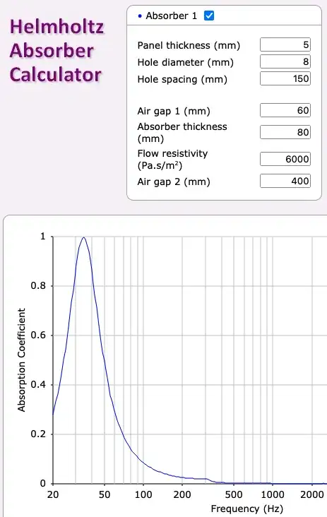

Here is my calculation for a Helmholz absorber (actually a multi-layer absorber)
Helmholz absorber calculation
(This is no standard helmholz resonator with a defined volume and one hole!)
Question: What volume or area should such an absorber have?
I have a massive old beech wood panel with about 150cm x 80cm that I could use as a back. The volume would then be 0.48 cubic meters. (180 x 80 x 40)

As to your question: "what volume or area should such an absorber have", the volume is the depth times the area, of course, and the depth in this calculation is given by the absorber "thickness" behind the perforated front. Some models call this the "construction depth", if the absorber material thickness is less than the distance to the backing.
As for area, it would be proportionate to the desired peak absorption. So to attain a peak of 0.5 * 1 (1 from the resonator's performance), you'd cover 50% of the wall on one reflective side, e.g. the back. That's your area, in theory.
Since you have a complex set-up of broad band absorbers, with reflective floors and ceilings and future furniture and human(s), the ultimate listening quality will not be easy to model and predict. Moreover, modelling and measuring small rooms is exceptionally fickle.
Also, you seem to be correctly concerned about T60 at 35Hz, which is important in critical music listening, but less so with movies which are mostly full of distracting wide band noise just when the 35Hz matters. Looking at your curves, the T20 or T30 at 35Hz seem to be less problematic, and might better predict what you'll experience in a movie.
In your room it's quite possible that after putting down carpet and furniture, you could probably do with equalizing the 35Hz down for music listening & movie watching, depending on the content.

  • Thanks. +1 :-) I could cover 13% of the wall with my material, so that 13% of the wave would be absorbed. But since the resonance is caused by multiple reflections, it is not possible to predict how this will affect the overall result, correct? – marsh-wiggle Oct 03 '21 at 07:05
