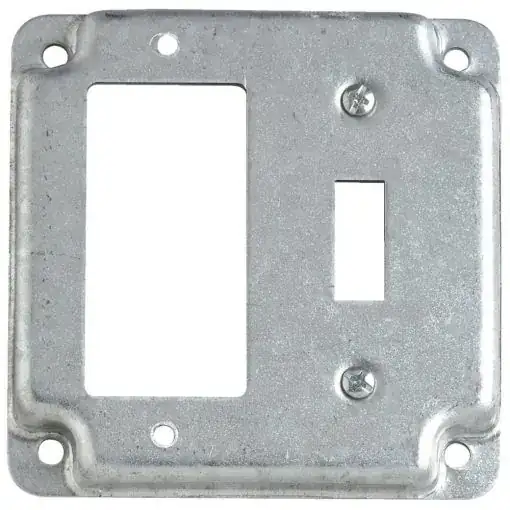

The problem is, the last guy used a cover plate intended for flush mount boxes that are buried in drywall. Probably because they are mind-controlled into only shopping at big-box stores.
You need a cover plate intended for surface mount metal Handy-Boxes.
Talk to a real electrical supply, they will have it, and will know what you want.

Easiest, if you can find it, is a proper sized plate, as Harper suggests. "I've looked for better plates and couldn't find any." - that is likely true at the big box (Home Depot/Lowes), simply because they only stock the higher-volume items. Every city - even those a bit too small for a big box store - has an electrical supply house. These places sell to electricians, contractors, etc. But almost all will sell to homeowners, at least for simple stuff. (They may, legitimately, be reluctant to sell a clearly amateur homeowner a full panel out of fear of liability and/or returns. Not an issue for a simple cover plate.) Even if they charge double for walk-in business, that's $ 2 instead of $ 1, so not a big deal.
Or just swap it for a bigger box. The knockout sizes are standard, so it should be no problem finding a match at any electrical supply house or big box and get a cover plate to match.

Could you go for something wider, get round edges, and place for an outlet: Thomas & Betts RS18CC This is a combination GFI toggle plate.

    Actually, it is a combination **Decora** /toggle plate. It happens to be that standard GFCI receptacles use the same form factor as Decora receptacles and Decora switches. Yes, the location likely requires GFCI, but not necessarily, and GFCI could be provided in the breaker panel instead of at the receptacle. – manassehkatz-Moving 2 Codidact Oct 03 '21 at 04:30
  • These "crushed corner" covers come in all configurations including just a light switch. To my knowledge there are no one-gang versions. And importantly, they also have a bit of an overhang. Not as snaggy as OP's cover but not totally smooth either. – jay613 Oct 04 '21 at 15:30
  • @jay613 You could fill in the smaller gap with silicone bead or something - might even be a good idea if this location is exposed to moisture. This would prevent both snagging and water leaking in, while still allowing the plate to be easily removed later if needed. (Unlike epoxy or other strong glue - which would also fix the snagging problem but leave future owners cursing your name for sealing it shut.) – Darrel Hoffman Oct 05 '21 at 13:32
