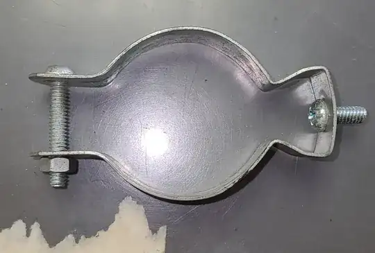

I would use a conduit hanger.
It goes around the pole, tighten the nut and bolt that's on the left side in Pic. This will clamp the hanger onto the pipe.
On the right side, I added a small bolt, this is where you would secure the winch to the hanger/pole.
conduit hanger conduit hanger on pipe.
** Edit ** You could use a piece of kindorf with a kindorf strap...
Strap around pipe, kindorf other side of pipe and attach winch to kindorf. If you don't have small fingers, attach winch to kindorf first. For added strength from the strap sliding around the pole, you can screw through the strap into the pipe.
They have different types of kindorf, thick/thin, holes or slots.
Everything I mentioned can be found in a hardware store or big box store.

  • The only potential drawback I see to this is that the torque of using the winch _could_ bend the stand-off portion of the bracket. Still got my +1. – FreeMan Oct 08 '21 at 14:51
  • Possible, let me grab a stronger hanger and add to my post. – Gunner Oct 08 '21 at 14:53
  • Ah, the new ones do seem stronger, than the zip-ties... But this also creates sharp edges on the other -- court- -- side of the pole, for a player to injure himself :( – Mikhail T. Oct 08 '21 at 15:11
  • Sharp edges are fixable with a file or grinder or even wrapped in rubber or pipe insulation after rounding edges. – Gunner Oct 08 '21 at 15:16
  • Not sure, if I can hook these through the existing holes in the winch, though... They are round -- made for bolts (or screws)... Ideally, it'd be something like [this](https://smile.amazon.com/dp/B08X2CPBH5/) -- but with threads rather than "ears" at both ends... A curved U-bolt. – Mikhail T. Oct 08 '21 at 15:18
  • You would attach the winch to the kindorf, cut down to the width of the winch. Using this setup will give more backing and stability to the winch. – Gunner Oct 08 '21 at 15:23

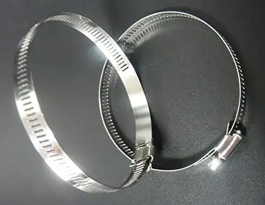

Secure it to the pole with two or three metal hose clamps.
hose clamps
The resulting strength of the attachment to the pole is incredible, and the large face with versatile holes allows you to attach your crank very securely also.

  • Thanks, I looked at these, but I don't think, they are strong enough for the sideways stresses of cranking -- by an enthusiastic volleyballer eager to start playing :) – Mikhail T. Oct 08 '21 at 16:38
  • These are much, much stronger than anything else that has been suggested here and 10,000,000 times stronger than your wire ties. Use two hose clamps, this spreads the load vertically. Rotationally around the pole, the edges of the mounting bite into the pole. – jay613 Oct 08 '21 at 16:44
    We're not using wire ties. We're using bolts -- because the pole already had them (something else used to be attached to it years ago). Did you mean the plastic zip-ties pictured? Those aren't adding much, I agree... – Mikhail T. Oct 08 '21 at 16:58
