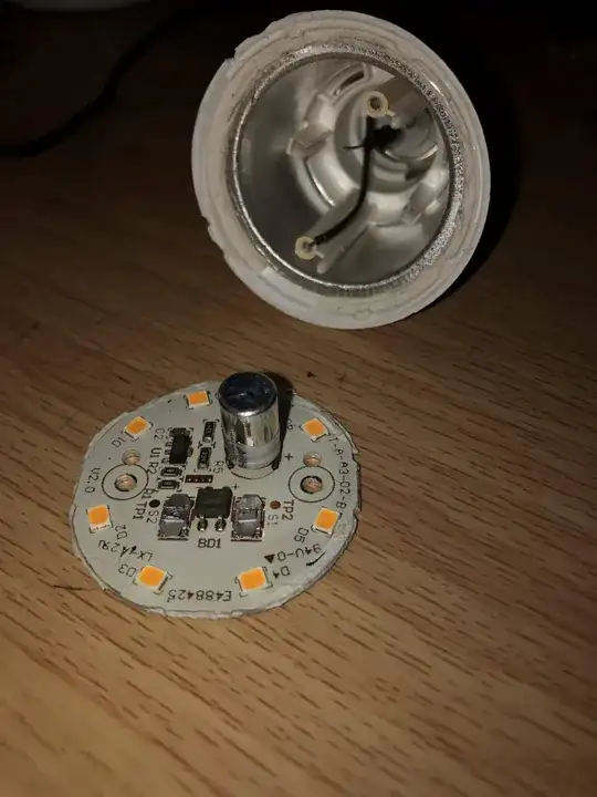

EDIT: These are the internals of a bad bulbLight bulb internals

    That capacitor tells the story. It got so hot, half its shrink-wrap label is gone. I can see burning of the PCB underneath. There's no tricks here - This bulb is, unfortunately, a piece of cr*p. Compare the spartan insides of that bulb to one from a reputable manufacturer such as Phillips or Cree. There's lots of teardowns on the 'net. You'll find alot more circuitry, and MUCH bigger heatsinks. Plus actual engineers who designed it. These cheap bulbs are 'penny wise-pound foolish'. Avoid them. – Kyle B Oct 13 '21 at 21:55

    I posted an image of the bulbs internals – Proxy303 Oct 13 '21 at 20:08

    Posted a picture of my bulbs internals – Proxy303 Oct 13 '21 at 20:08

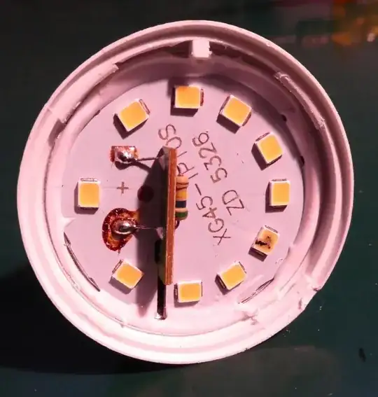

I'd like to know where you folks are getting LED bulbs with constant current sources that can be adjusted. The bulbs I've disassembled didn't bother with such niceties. They have capacitive dropper circuits in them. They depend entirely on the line voltage and the capacitance to keep the current (somewhat) correct.
Here's a bulb I tore apart last year:
It was still functioning, but had developed a bad tendency to blink on and off at odd intervals.
You can see that one LED is already damaged - the one in the lower right corner has a black streak across it, and it no longer lit up.
Here's the internal circuitry:
The only semiconductor in the whole thing is an MB10F bridge rectifier.
I traced out the circuit:
As you can see, the only thing limiting the current to the LEDs is a 920nF capacitor.
The current to the LEDs depends on the line voltage, the reactance of the 920nF capacitor, and the forward voltage of the LEDs. Line voltage varies some over the course of the day, and it gets disturbances and surges to higher voltage occasionally. The forward voltage of the LEDs varies with temperature - the forward voltage is lower for higher temperatures.
Voltage surges can cause a high current to flow through the LEDs for a short time.
High temperatures can cause the current to always be higher than planned. That means even just the fact that the LEDs get warm in operation can make them draw more current.
The surges can cause sudden failures, the higher current from temperature variations can cause lower amounts of damage that slowly destroy the LEDs.
You'll see folks saying that it's the power supply sections that go bad and that the LEDs are OK. As you can see in the pictures above, the LEDs aren't OK - and in this case, the power supply was fine (though really crappy.)
The only way to fix these LED bulbs would be to replace the circuit with a decent constant current source. You can't really build one yourself - the LEDs in the bulbs don't come with datasheets that would tell you the needed information (current limits, forward voltage range, temperature coefficients, etc.) to design a proper circuit.
